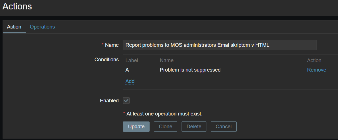

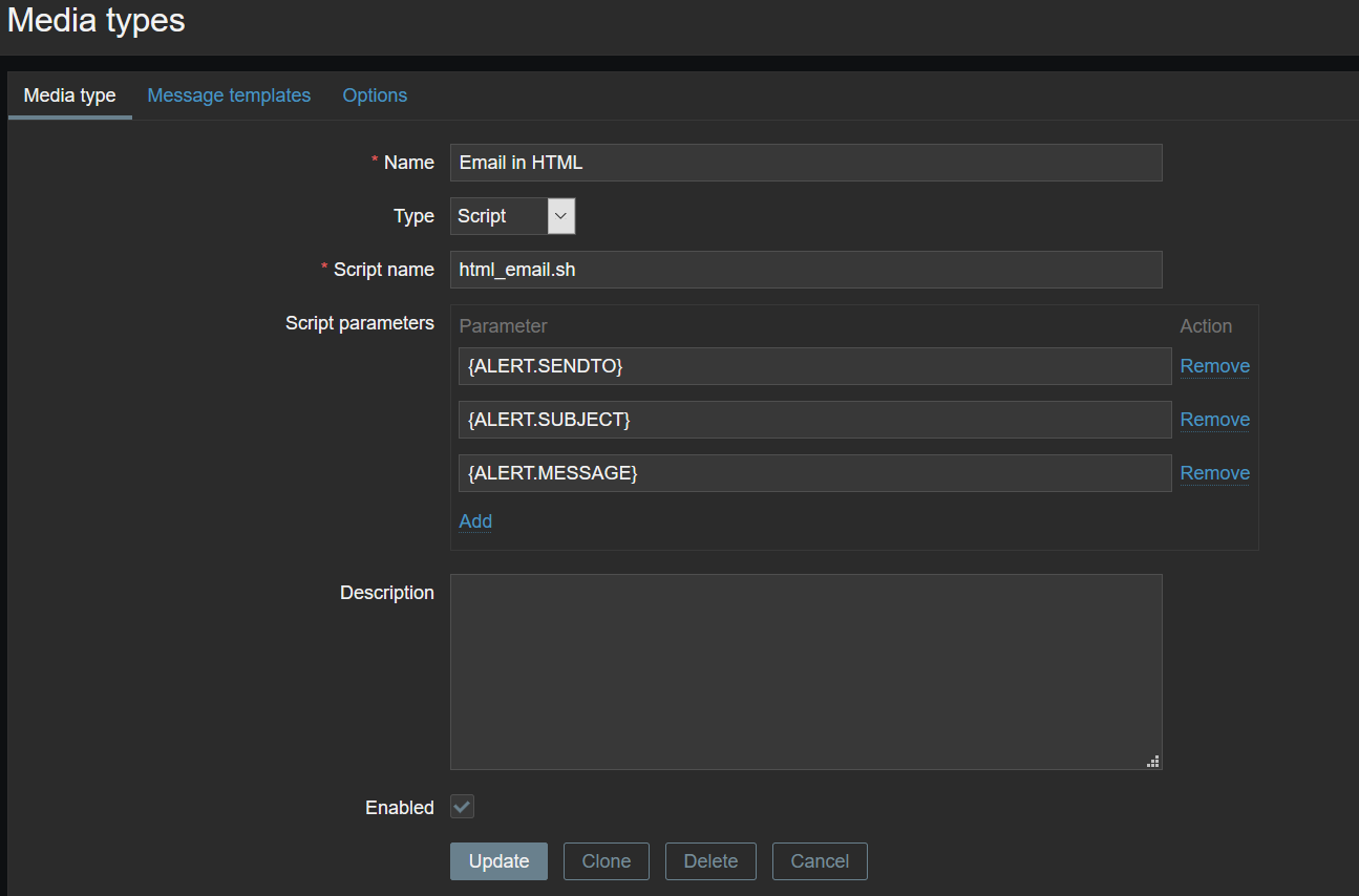

              • Rudlafik
                • Nov 2018
                • 168
                Install to ZBX srv https://linuxhowtoguide.blogspot.com...tp-client.html
                PrefixYourCompanyInO365.mail.protection.outlook.co m = definition you find in admin portal your company o365
                write this script.
                chmod +x /usr/lib/zabbix/alertscripts/html_email.sh
                html_email.sh
                e-mail
                export smtpemailfrom=NonExistClientEmailAddress@Yourcompa nyDomain.Prefix
                export zabbixemailto="$1"
                export zabbixsubject="$2"
                export zabbixbody="$3"
                export smtpserver=PrefixYourCompanyInO365.mail.protection .outlook.com
                /usr/local/bin/sendEmail -f $smtpemailfrom -t $zabbixemailto -u $zabbixsubject -m $zabbixbody -s $smtpserver:25 -o tls=no \-o message-content-type=html
