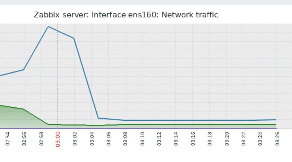

    I have noticed the zabbix chart has been dead since the past 12 hours ago.
