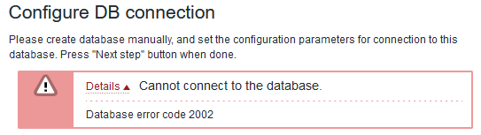

    Hey everyone,
    For severals hours I am trying to configure this TLS connection, I am stuck on the frontend installation screen, do not know which certificates and what paths need to provide in:
    TLS key file
    TLS certificate file
    TLS certificate authority file
    I have generated crt and key files from the *pem files (after running mysql_ssl_rsa_setup),but now I am not sure if those are the right files, maybe I should use the pem files instead?
    Tried with the files on zabbix server and path like /home/etc/etc/, but later saw here https://blog.zabbix.com/whats-new-in...5-0-lts/10714/ that path is c:\ so copied it locally to the PC I am runnig configuration on - no luck.
    Appreciate any help on this,
    Cheers,
    J

      Tested it, does not work with certs from /var/lib/mysql, tried with server* ones and client* ones, tried with *pem ones and converted it to *crt and *key and tried, tried to give paths from my PC, a well as from Linux - nothing. also created user zabbix on the DB with 'require x509'. still nothing - all the time I am getting:
      Details Cannot connect to the database.
      • Database error code 2002
      EDIT: Workbech works great with these certificates, I needed to use the cliet ones - despite providing the same configuration:

      Any help on how to configure this TLS connection greatly appreciated.

            Seems it works for the zabbix_server, what had to be done was to change DBTLSConnect to "required", I am not specially happy with that but still - at least works for the server. But cannot do the same for the UI - has anyone tried to configure this? Still no matter what I am getting "Database error code 2002".
            • mix091
              • Dec 2020
              Have you resolved this problem? I have the same issue...
              I also configure zabbix_server over tls with DBTLSConnect "required" successful, but I can't do this with zabbix-frotend Each attempts ends with "Database error code 2002".
