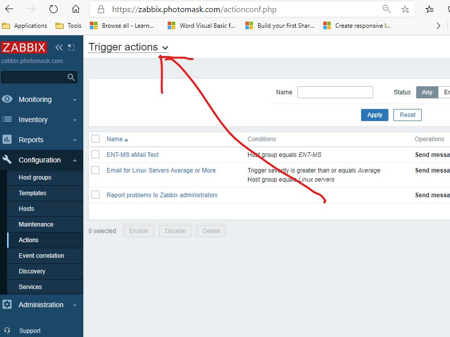

          When I Look in Configuration > Actions, in the drop-down list is nothing about Discovery Rules in Conditions

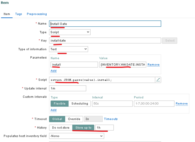

                  Add item, the parameter is as follows,
                  name: install value: {INVENTORY.HW.DATE.INSTALL}
                  The script is:
                  return JSON.parse(value).install;

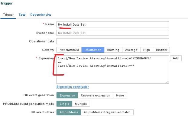

                  Add Trigger, expression:
                  last(/New Device Alerting/installdate)="*UNKNOWN*"
                  or
                  last(/New Device Alerting/installdate)=""​

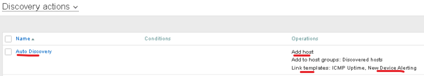

                  Go to Alerts > Actions > Discovery Actions
                  Create or update your rule, to link your new template to discovered hosts.
