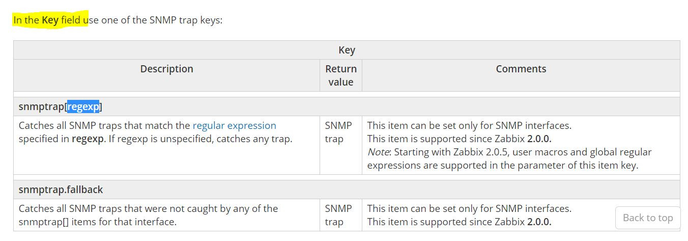

          where can I see what is specified in regexp?
          Catches all SNMP traps that match the regular expression specified in regexp. If regexp is unspecified, catches any trap

            You specify this regex expression yourself. For example, an item with the snmptrap["\bXXX\b"] key will only catch traps that have XXX in the text.
            may be this help? https://blog.zabbix.com/snmp-traps-in-zabbix/8210/
