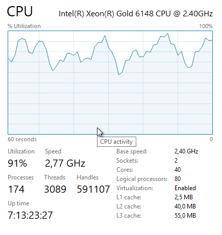

    Hello,I'm using Zabbix 4.4.10 to collect CPU load on a Windows 2019 server running HyperV.
    I have a VM using all 40 CPUs from my server quite a lot.
    Windows shows a CPU utilization between 70% and 90% all the time but Zabbix agent is only saying less than 1%... why ?
    Thanks for your help.

      Sorry you are right I copy the wrong picture... it's Cpu usage that is around 1% all the time
