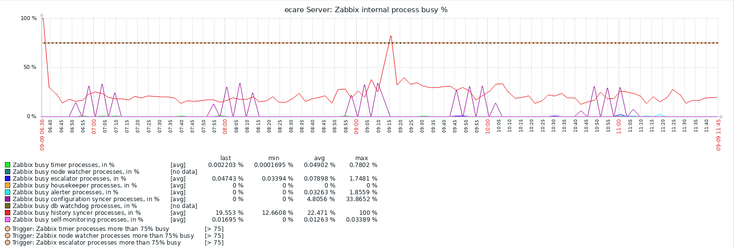

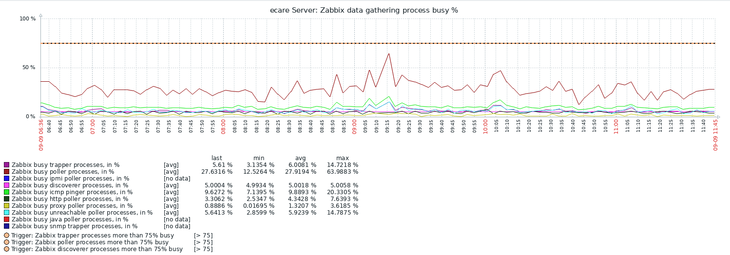

    Hi, I've a large Zabbix 5.0 environment composed of:
    - single Zabbix Server VM (6 vCPU, 16Gb RAM)
    - single MySQL 5.7 VM (6 cCPU, 32Gb RAM, storage write speed at about 350 MB/s from inside mysql's data directory)
    - 90 Zabbix Server Proxy with compression enabled.
    - 7500 monitored host (6000 enabled / 1000 not enabled).
    - 570.000 items (420.000 enabled, 120.000 disabled, 25.000 not supported)
    - 209.000 triggers
    - Required server performance, new values per second 5550.00

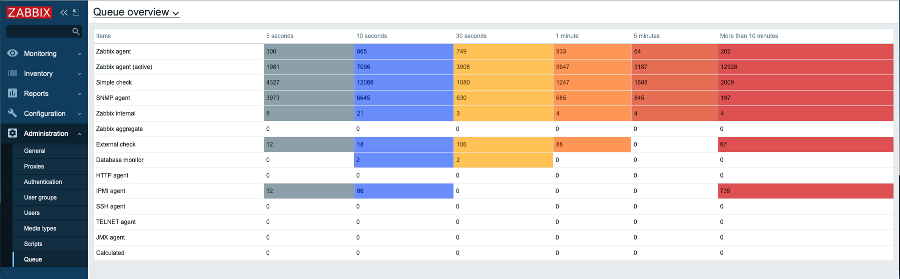

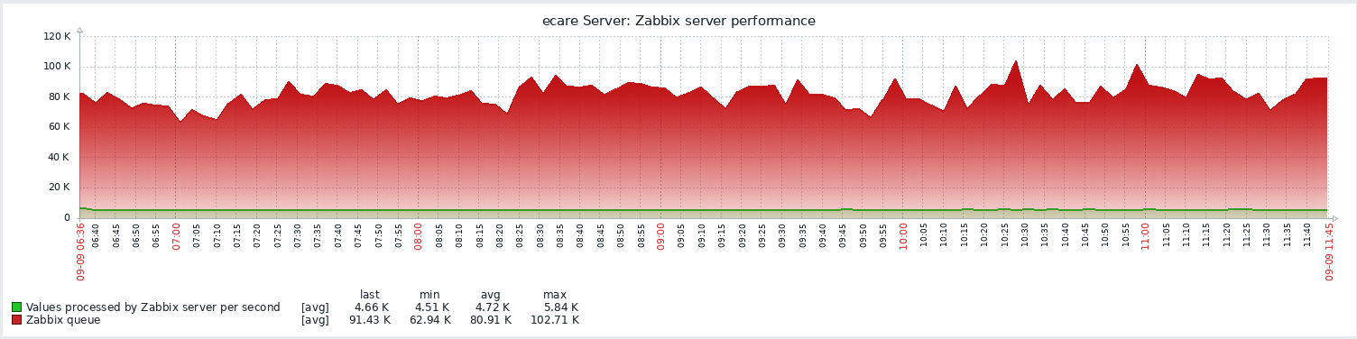

    My current annoying problem is the Zabbix Server's Proxies queue
    As you can see on attached graphs, we have a Queue at about 80K entry and a "NVPS" at about 5K.... by this way I doubt that the situation could be better in the future...
    How can I increase my Zabbix's NVPS capacity?
    In your opinion the problem could be on Zabbix Server? Mysql? Proxies??
    Thank you in advance for any help.
    Regards,
    Fabrizio
