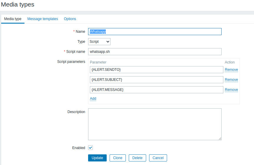

    Hello, I have the following problem, when passing parameters to my script, zabbix places a single quote and not a double quote, this makes my script not run.
    zabbix_server.log
    1152:20200923:225459.007 Failed to execute command "/usr/lib/zabbix/alertscripts/whatsapp.sh '50767828931' 'Test subject' 'This is the test message from Zabbix'": Timeout while executing a shell script.

    While it's true that on UNIX and Linux there are important differences between how a Bourne-like shell handles single-quoted arguments vs. how it handles double-quoted arguments, there's nothing in the log message you show that suggests to me the problem is quoting. My guess is the problem is somewhere else.

      You are absolutely right, I already solved it, I was misplacing the phone number due to fatigue

        Glad you got it solved and that you followed up and confirmed the issue wasn't quoting!
