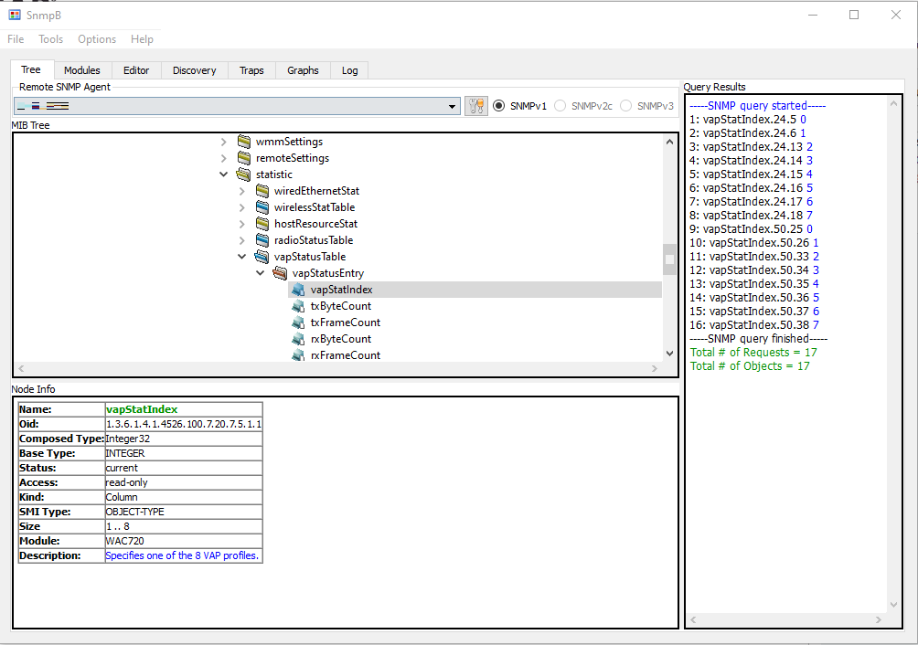

    Hello everyone,
    Tring to add Netgear WAC720 access point to Zabbix.
    I have OIDs wich don't fill the discovery macros :
    OIDs are for example :
    - 1.3.6.1.4.1.4526.100.7.20.7.5.1.1.24.5
    1.3.6.1.4.1.4526.100.7.20.7.5.1.1.24.6
    1.3.6.1.4.1.4526.100.7.20.7.5.1.1.24.13
    1.3.6.1.4.1.4526.100.7.20.7.5.1.1.24.14 etc...
    My discovery OID is the following :
    discovery[{#VAP24INDX},1.3.6.1.4.1.4526.100.7.20.7.5.1.1.24] (I truncated the OID, in real, there's others macros in it)
    But of course, it doesn't work. I even not get the 0,1,2,3... values... I still get {#VAP24INDX}
    How could I get the last digit of the OID, without the value, because I need to use it in an other place... I precise those values are not readable anywhere else in the MIB, except at the same place on other OIDs.
    Nicolas

      What error message are you getting on the host item?
      What does your item prototype look like?
