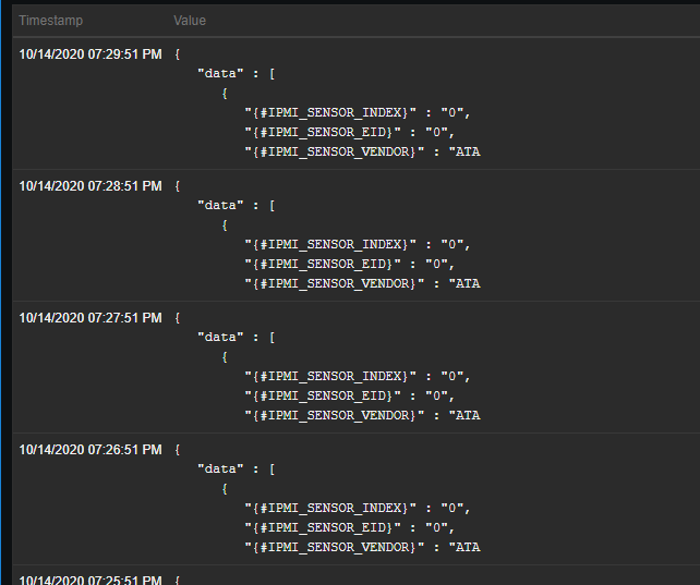

    I've been experimenting with Items, Discovery Rules and Item Prototypes. So far, the only config I've gotten to capture visible data on the Host is by creating this Item under the template.
    Name SMCIPMITool Discovery
    Type External check
    Key ipmi-sensor-discovery.sh["{$HOST.IPMI.CONN}","{$HOST.IPMI.USER}","{$HOS T.IP MI.PASS}", "hdd info"]
    Type of information Text
    Update interval 1m
    The data being captured only seems to be capturing the first 6x lines of the output.
    Is there a reason why it's not capturing the rest of the Shell script output?
    Am I taking the best approach here or is there a better way to do this?
