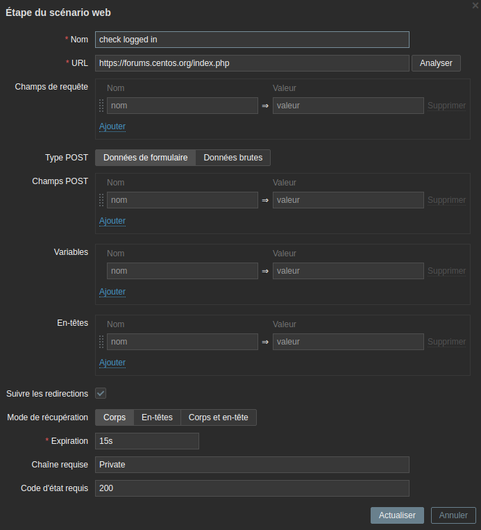

    My second step :
    The string "Private" should be on the monitored page once correctly logged in so my guess is that i'm not connected at all.
    Am i doing something wrong ? Is there a better way to login to a POST form and checking if you're logged in ?

      Yes, i have successfully set up the real life scenario in my zabbix (logging into zabbix, checking, disconnecting). Works like a charm.
      I haven't set up the sid yet because I thought it was only needed for disconnection purposes later on. I'm gonna try to get it and pass it to my other steps. Thanks for the tip.
