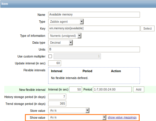

        By default, Zabbix have some "Value Mapping" presets.
        One has a name "Service State" and mapping 0 & 1 to Down & Up.
        So, the easiest way to use it - configure your item to use "Service State" value mapping for the field "Show value"

          As Aib mentioned, value mapping will help in some areas, but not all.
          At least in my 2.0.9 setup, a graph will still indicate only the return code instead of the value mapping - unfortunately. I think maybe this was going to be addressed in a newer release than what I am running.
          My workaround is simply to create a custom graph and in the graph description I put the legend, such as:
          "My App Services 0 = Down; 1 = Up" or whatever the case may be.
          Alerts will correctly show the value mapping along with the return code though without any modification.
