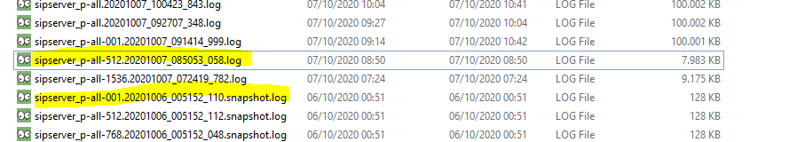

    I am creating a monitoring, however I am having a problem with a file inside the directory.
    In the image you can see that. I have two files, one .log and the other .snapshot.log. free 3D modeling software
    I just want to read only .log files and skip files .snapshot.log

    Use regex
    ^sipserver_p-all-[\d|_|\.]+\.log$
