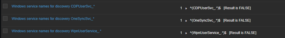

    I am not interested in monitoring these services , i have tried deleting the items , as they are auto-discovered services from template they show up again .
    I have tried using regular expression but i still get flooded with problems from these services .
    Here are the expressions ,
    Any ideas what i did wrong with the expression ?

      In the Windows Services Discovery template, there are some template level macros containing regular expressions that define which services "match" or "do not match". You should modify this regular expression macro.
      Sorry I'm being a little vague, I'm not in front of a Zabbix implementation at the moment. I'll try and update my answer soon, but for now that might give you some hints.

        I found the section in the template and made the change , for now it seems to work , ill update soon

          Thanks very much , it works
