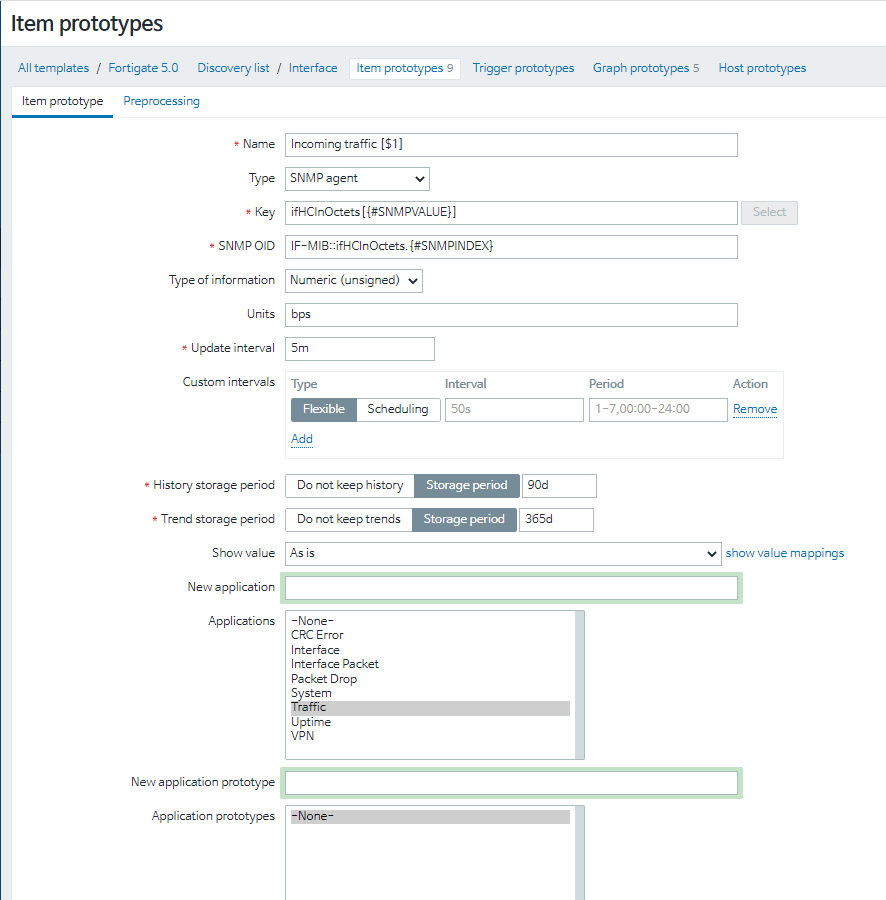

    I am using discovery rule to retrieve SNMP items from my Firewall devices.
    However, it brings all of the interfaces even though some are not being used.
    I want to filter out them so I don't have to see an infinitely long 'screen' with a bunch of graphs.
    Can anyone please help?
    By the way, this is from a template for Fortigate devices.
    In this case, I want to only see one graph for 'wan1' interface since the others are not being used.

    Use the "Filters" tab in your discovery rule to filter out items with incoming traffic / outgoing traffic = 0.
    like : {#INCOMINGTRAFFIC} "does not match" 0
    AND {#OUTGOINGTRAFFIC} "does not match" 0
    Then, to shorten your screens with discovery items in them go to your template -> screens -> properties: set columns to 2. Then go into constructor, choose your item prototype, set max columns to 2 and column span to 2.
    This makes it so 2 item prototype graphs are shown per row in your screen.

      Thanks a lot for the comment! I was trying to filter out using {#IFOPERSTATUS} "does not match" 0 but did not work.
    • ykdhan
      ykdhan commented
      I tried using IfInOctets AND IfOutOctets "do not match" 0 but this neither works. It still retrieves data from every interface.

    IfOperStatus has many different states - not just 1 and 0. IfInOctets and IfOutOctets are the right OIDs to use for this.
    Just play around a bit with regex until you find something that fits your needs: https://www.regextester.com
    • ykdhan
      ykdhan commented
      Thank you. The problem was my old SNMP data keep showing. I deleted the host and created it again. Now the filter works.

    Even though this post is very old, I figured that someone still might look it up.
    The problem here with OP is when you do a discovery on interfaces, Zabbix will store the discovered interfaces even though they afterwards are being filtered out. OP has set Zabbix to store his discovery in 30 days, by setting it under this field.
    Change this value to 0 and Zabbix will refresh to new interfaces discovered immediately.​
