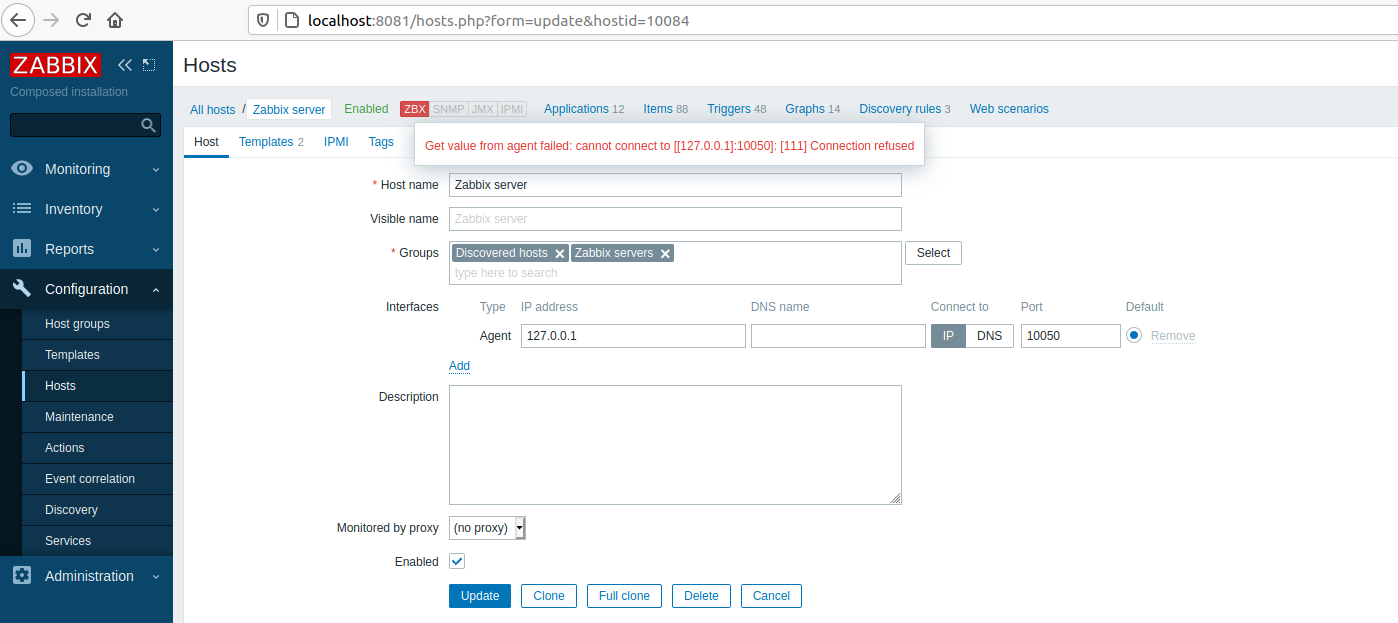

      OK I understand. I am sending the host configuration in the attachment
      After logging in to the zabbix website, there is one entry in the host tab. This is an entry that has existed here from the very beginning. in the docker-compose.yaml file, zabbix agent is set to port 10050, which is the same as in the configuration on the website. The agent was installed on the same computer as the server, so the agent's IP address should be 127.0.0.1. It doesn't install a proxy because I wanted to use a direct server-agent connection.
      Why, despite the default configuration, does the host return the message "Get value from agent failed: cannot connect to [[127.0.0.1]: 10050]: [111] Connection refused"?
      I'm sorry if I ask the same, but I don't really understand why, despite the default configuration, the host cannot connect
      • Atsushi
        • Aug 2013
        • 2028
        If Zabbix server and Zabbix agent are running in different containers, they will not be accessible through the localhost loopback interface (127.0.0.1). 127.0.0.1 can only be used in the same container. Try specifying the interface of the host "Zabbix server" with the name "zabbix-agent" using the DNS name.
        The default is 127.0.0.1, probably because the initial database is registered with the same SQL statement as during normal installation.
        • Eric25
          • Nov 2020
          • 16
          thank you very much! you saved a few hours of work for me. Nowhere could I find any information as to why this is happening.
          Another problem was setting the network adapter in virtualBox. The primary setting was the NAT card, so I couldn't see the page on the same network. Switching to a bridged card did the trick. Now I will start the client on windows. Thank you very much for all your help!
