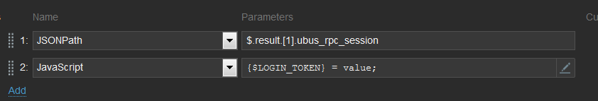

    Hi
    Is it possible to save a value of the item to macro via Javascript preprocessing?
    First rule is JSON path that work, second doesn´t.
    I tried this code, but I got an error.

    Thanks in advance. D.

      But you can use user macros there (https://www.zabbix.com/documentation..._location_user)... So, with a bit of coding (JS preprocessing...) you should be able to update a host level macro, where you keep that acquired value... Just don't ask me for any examples..​ I suck at coding..​ But I have seen similar approach to update some date related global macros. Or you move that first step, acquiring a token, into a script somewhere on zabbix server, and update that macro from there, gives you more coding language options....
        You need to do a API call inside that JS to set a macro value.
