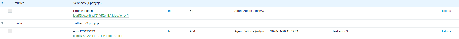

    Hi guys,
    My problem is that i would like to monitor few files in one directory, <D:\logs>, every name starts with data like <2020-11-19_app.log> and app creates new file everyday.
    Im trying to use logrt but i cant solve this problem.
    im trying with something like this, i checked regex101 and it should find this file,
    logrt["D:/.*.log","error"]
    Please help me and thank you
    Do you have any idea how i could check logs for errors, warns etc but not with .*.log? any idea how i could connect data with file name?
    for example today i would like to scan only files which starts with 2020-11-19

    logrt["D:\\\d{4}-\d{2}-\d{2}_app\.log","error"]
    • Konrad_22
      • Oct 2020
      I still have problem with that file, the string with localisation looks ok but i get my data only when file localisation is not set as regex
      any solutions?
      • Konrad_22
        • Oct 2020
        Could someone tell me where the regex should start in the file path? for example file name
        logrt["D:\app\zabbix\logs\\\d{4}-\d{2}-\d{2}_app\.log","error"]
        is ok? because zabbix cant reach this localisation
        • Hamardaban
          • May 2019
          • 2714
          I have this version of the expression that works:
          logrt["D:\app\zabbix\logs\^\d{4}-\d{2}-\d{2}_app\.log$","error"]
          in this expression, the regular expression describes only the file name.
          • Konrad_22
            • Oct 2020
            sure but why it cant find any errors? i have same problem zabbix find files .*.log but cant find errors, warnings etc
              • 4985
              logrt["D:\\app\\zabbix\\logs\\\d{4}-\d{2}-\d{2}_app\.log","error"] missing couple of \-s, I think.
                • 4985
                Just out of curiosity
                Added a file to a box, I have here .. C:\apps\logs\2020-11-20_app.log
                added an item
                logrt["C:\app\logs\^\d{4}-\d{2}-\d{2}_app\.log$","error"]
                It became "Not supported": Cannot compile a regular expression describing filename pattern: PCRE does not support \L, \l, \N{name}, \U, or \u
                changed to
                logrt["C:\\app\\logs\\^\d{4}-\d{2}-\d{2}_app\.log$","error"]
                Became supported...
                Using 4.4.10 here...
                It still fails to find any "error"-s I write in there, but that's another story...
                  • 4985
                  Good question.. I found an aswer from agent logfile
                  1340:20201120:142105.961 there are no recently modified files matching "app\\logs\\^\d{4}-\d{2}-\d{2}_app\.log$" in "C:"
                  I had made a mistake.. one missing s in path..
                  After that also the version what Hamardaban suggested works, with single \-s
                  EDIT: point being... look int agent logfile, maybe you find something useful there..
