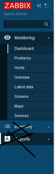

how to hide/show menu frontend menu items for guest zabbix 5.01
  • korayak88
    • Oct 2020
    • 19
    I want to hide some menu for zabbix guest user. Is there a possible?

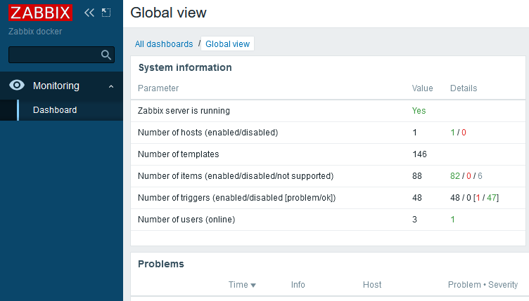

    Hello cyber,
    thanks for your interested.
    Yes, i have tested and it is running.
    But there is a mysql problem. I think everyone should pay attention when upgrade the zabbix 5.4. I enclosed error and there is no solution yet.
      5.2 introduced "Roles", what enables you to do this. For earlier version, no such luck.
        Upgraded from 5.0 to 5.2? Probably something went wrong with db upgrade. Dig into logs and try again. There are multiple threads here with similar issue, read them, may help you also.
