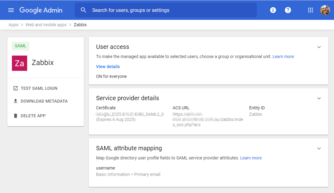

    Google side:
    In addition to this, I copied the contents from the 'Certificate' section of the 'Download metadata' window (click the link from the menu on the left in the screenshot above) and pasted it into /user/share/zabbix/conf/certs/idp.crt
    Hopefully the above is enough for anyone else who get stuck like I was. Please get in touch if you need more info on setting up the Google Workspace side.

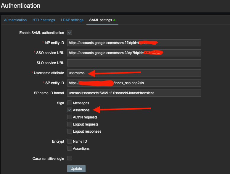

          Hi guys,
          Just in case, this is how it was solved
          1) It's very important to follow what KentW suggested: In addition to this, I copied the contents from the 'Certificate' section of the 'Download metadata' window (click the link from the menu on the left in the screenshot above) and pasted it into /user/share/zabbix/conf/certs/idp.crt, that is just copying the certificate that google shows and creating a file idp.crt and pasting that information on that route (at least at Ubuntu)

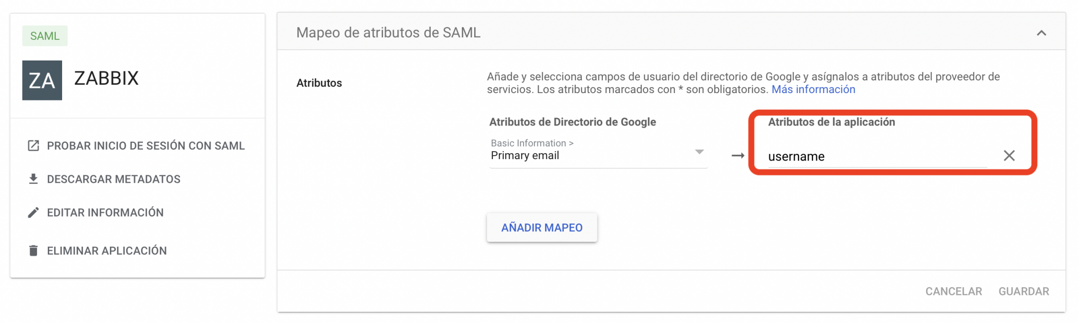

          2) On the mapping, the attribute username has to match what the zabbix Username attribute, also checking the Sign: Assertions and the SP Identity ID is the url of the same zabbix whether you have as a name or ip
Name:	Screen Shot 2022-01-15 at 13.38.20.png
Name:	Screen Shot 2022-01-15 at 13.34.09.png
Name:	Screen Shot 2022-01-15 at 13.33.06.png

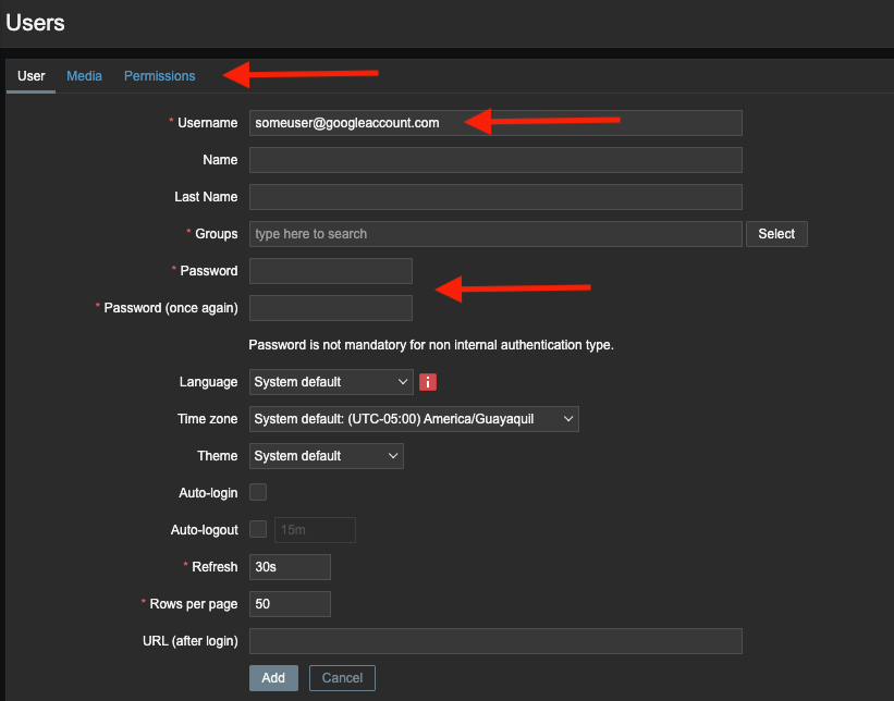

          Then everything works great...just a final tip, log out from you google account when you test it on the browser, otherwise will prompt an error of permissions on Zabbix
          Finally, you have to manually create the user on Zabbix Users, the password don't matter you can type whatever password and will still log in with the google account password, but it has to be created, otherwise it won't work. That is how you assign the role and permission to the user

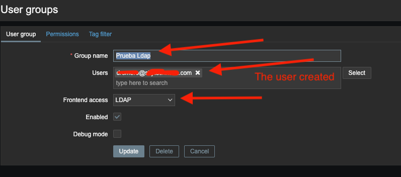

          For me at the beggining was like...ok but what if the user logs in with the google account and change the password locally, will the user log in without SAML? Well the answer is yes (so what's the point right?), but as a hint you can create a LDAP group pointing to nowhere and the user add it to that dummy group, then he still can change the password, but when trying to log in will prompt LDAP Group not working, and the only way the users can log in is with SAML

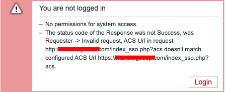

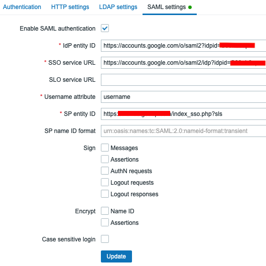

                Hi guys! I'm having some issues making this work on Zabbix 5.4.10.
                My Google SAML configuration looks like this:
                Click image for larger version  Name:	Screen Shot 2022-03-03 at 1.31.23 PM.png Views:	0 Size:	66.9 KB ID:	440789
                My Zabbix SAML settings looks like this:
                Click image for larger version  Name:	Screen Shot 2022-03-03 at 1.31.01 PM.png Views:	0 Size:	50.6 KB ID:	440790
                The error that I get is:
                Click image for larger version  Name:	Screen Shot 2022-03-03 at 1.34.03 PM.png Views:	0 Size:	24.6 KB ID:	440791
                And I have created a Zabbix username using the Google User's email address as the username.
                What am I missing here?
                Thanks!

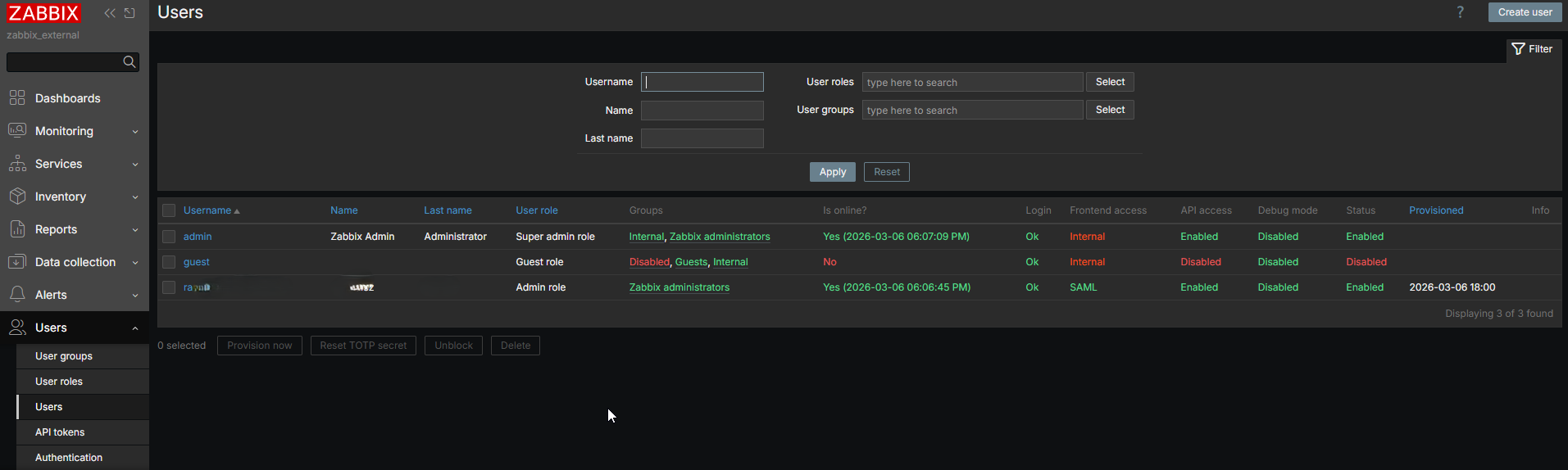

                    Recently came across this while doing my own setup for zabbix SAML to google workspace. Though I was also able to add JIT so that users are automatically created upon login.
