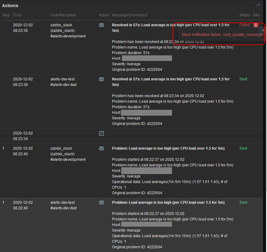

We're trying to send notifications to multiple Slack channels as more than one team may need to be alerted to an issue. The default JavaScript for Slack integration in Zabbix 5.0.4 seems to be able to send a notification to multiple channels without any issue, which is great.
However, the issue we're experiencing is that Zabbix only ever closing/updating one Slack notification and failing on the other.
Has anyone found a way to fix this where Zabbix can update/close notifications in multiple Slack channels?
As per the attachment, you can see that two notifications are successfully created (And verified in Slack), but when the notification is closed, one of the notifications returns the message "Slack notification failed: cant_update_message".
