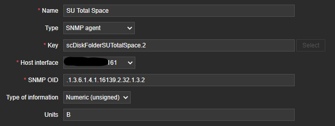

    I am trying to monitor disk space for a Dell SC2020 via SNMP. The OID value reports in GB.
    Example from SNMP query:
    Name/OID: scDiskFolderSUTotalSpace.2; Value (Gauge): 24964
    Item Screenshot:
Name:	Screenshot 2020-12-02 164954.png
    When I specify GB in Units, Latest Data shows KGB. I refer to Unit Symbols in the documentation, and use G, but I get KG.
Name:	Screenshot 2020-12-02 165249.png
    Ideally, I want it to be displayed in TB as a float.
    I am currently using Zabbix 5.0

      Thank you for the information. I made the change, and now it is reporting in KB, and not GB. I tried changing from a float to unsigned, and it reported the same number displayed below.

      Is there some preprocessing that needs to be setup?

          Since the SNMP value was reporting in GB, I added a preprocessing multiplier rule for 1073741824 Bytes, or 1GB, then set Unit to B, and it calculated the correct number for TB.
