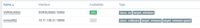

    I'm looking to achive the same thing.
    Either have the same tiggers / alerts / graphs on vmware guest machines that we have with the agent or merge the vmware guest with the zabbix agent.
    Example:
      These are not same names. Zabbix is case sensitive, so case matters.
      These represent 2 different views of same thing... one is vmware view, other "from inside". Seemingly similar metrics can be different from those viewpoints... And you probably cannot get lots of things through vmware, what you get through agent.
      I have not used vmware side myself, so I don't have any good advice here... but maybe, if you try to name them same way, it wont add new host but uses existing one?
