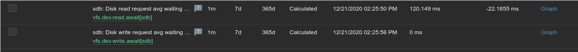

    I'am using Zabbix 5.0.6 for monitoring Arch Linux host. The problem is I am getting wrong data for the item vfs.dev.read.await[sdb].
    The disk /dev/sdb is dedicated completely to a VM, the problem is, when the VM is running I get correct values, but when the VM is shut down I get extremely high values, like 100-150 ms triggering an alarm.

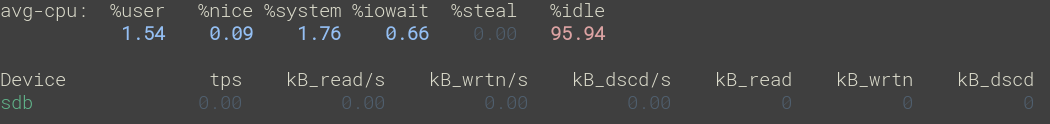

    I checked with iostat, and. in fact IO equals 0. Meanwhile, I have more disks on that host and the r/w await time is reported correctly.

    What should I be looking at?
    I attach screenshots.
