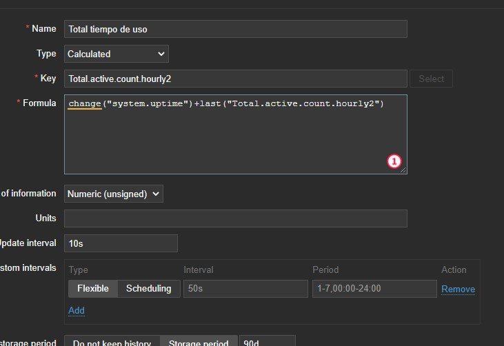

    I'm trying to create an item that stores the total number of hours the computers are on.
    I have created a calculated item
    key= total.hours
    Fomula = last("total.hours")+diff("system.uptime")

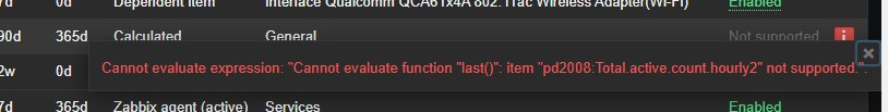

    But if it's the first time or it has no total value.hours gives an error.
    "Cannot evaluate expression: "Cannot evaluate function "last()": item "pd2008:total.hours" not supported."
    How can I store and add up all the hours that the item is active?

    Your expression does not work because there is no initial value for this item.
    And if it is not, then the last() function will not work and item will not work again.
    Change the formula for example to 0+0, wait for the expression to trigger and write the value to the database, and then change the formula to your own.
    Try searching the forum - this topic has already been discussed.

      Probably it would be more correct to use change()

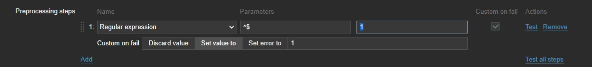

          Use preprocessing to write the initial value when an item error occurs

            I think I'm doing it wrong, I'm still failing. :-(

            • hectorsaratoga
              • Oct 2018
              • 14
              I'm really going crazy, I've tried a thousand things and I don't get it
              I don't understand what I have to do :-(

                Originally posted by cyber
                Let that regex return whatever there is, but set "Custom on fail". That will set value to something you like, if there is no value at all and calculation fails...
                It's a clever trick, but "Custom on fail" won't work. But maybe a new option "Check for not supported value" in version 5.2 will help.

                  cyber commented
                  Yep, I should not write things, while on vacation.. Of course it won't help, if there is no value present...

                So there's no way to do a sum a = a +b without failing the first time, no?

                      • 4993
                      • Semiadmin
                        • Oct 2014
                        • 1626
                        It works in 5.2.6 via "Check for not supported value" preprocessing.
                        But be careful: in early 5.2 minors, this trick leads to zabbix server restart.
