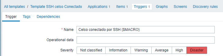

    Hi, is it possible create a trigger that on his name has a variable as MACRO?
    I want to the return of my {$MACRO} be part of the name of my trigger alert like:
    Celso conectado por SSH test.
    Is that possible?
    How do I do that?

    Isn't something working for you?
    Just keep in mind that a macro is just a string. they are not interpreted as commands.
    User macros can be used in:
    • item name
    • item key parameter
    • item update intervals and flexible intervals
    • trigger name and description
    • trigger expression parameters and constants (see examples)
    • many other locations - see the full list

      I was trying to use MACRO, but is something else a variable that i can MAKE the agent_zabbix run on the remote host and its result be used as part of the name of the trigger.
      Thanks.
