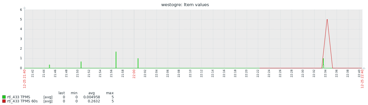

    I am counting number of lines in a log file that contain the string "TPMS". I have two items:
    logrt.count[/tmp/rtl433.json,TPMS,,,skip] with an interval of 1s
    and
    logrt.count[/tmp/rtl433.jso.,TPMS,,,skip] with an interval of 60s
    I just added the latter version of the item, my thinking behind this is that I do not need such granular data here, a count over the past minute would be adequate for my not-statistically-rigorous analysis of traffic in the neighbourhood.
    Graphing them together and looking at the hits:
    Click image for larger version  Name:	rtl433.png Views:	0 Size:	23.4 KB ID:	415799
    I don't understand why my 1s interval item seems to graph so much smaller than my 60s interval item. These are the relevant log entries:
    {"time" : "2020-12-25 22:00:44", "model" : "Abarth 124 Spider", "type" : "TPMS", "id" : "0cb55cd4", "flags" : "05", "pressure_kPa" : 238.740, "temperature_C" : 14.000, "status" : 80, "mic" : "CHECKSUM"}
    {"time" : "2020-12-25 22:33:38", "model" : "Ford", "type" : "TPMS", "id" : "66a6f7bb", "code" : "7c024b", "mic" : "CHECKSUM"}
    {"time" : "2020-12-25 22:33:42", "model" : "Ford", "type" : "TPMS", "id" : "66a5fb2e", "code" : "78bd4b", "mic" : "CHECKSUM"}
    {"time" : "2020-12-25 22:33:42", "model" : "Ford", "type" : "TPMS", "id" : "66a5fb2e", "code" : "78be4b", "mic" : "CHECKSUM"}
    {"time" : "2020-12-25 22:33:42", "model" : "Ford", "type" : "TPMS", "id" : "66a5fb2e", "code" : "78bf4b", "mic" : "CHECKSUM"}
    {"time" : "2020-12-25 22:33:42", "model" : "Ford", "type" : "TPMS", "id" : "66a5fb2e", "code" : "78cb4b", "mic" : "CHECKSUM"}
    Can anybody explain this to me?

      I suppose it's just a visualization. Look at the legend, you can see max 5 on both graphs.
      But a green graph has much more (60 times) values than a red one, so there are many values by one pixel in the green graph, one value 5 and several values 0.
      So a graph shows the average value of them.
      There are only 4 lines in 22.33.42, so maybe max 5 on a green graph applies to an earlier time, probably 21.57.

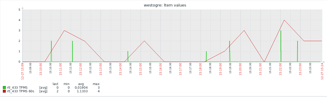

        Because the 1s items are next to each other, rather than stacked one above the other.
        It does lead to wildly different average values, however - two orders of magnitude difference:
        Click image for larger version  Name:	rtl433-2.png Views:	0 Size:	36.3 KB ID:	415836
        Which average is correct? Perhaps taking the mean of a series of impulses is irrelevant, so they're both nonsense?

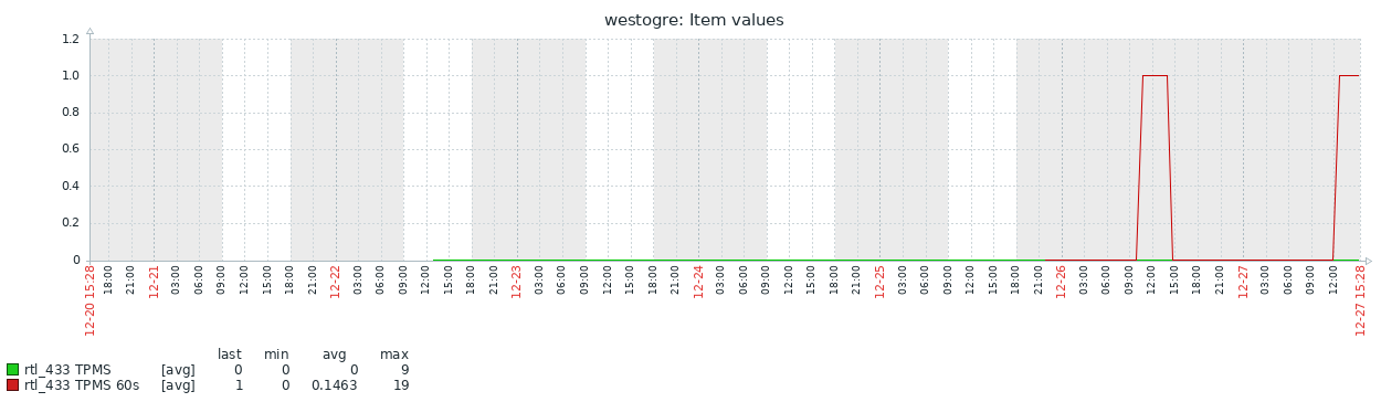

        • troffasky
          • Jul 2008
          • 631
          Another thing, zooming out to a week's worth, the graph is even less useful:
