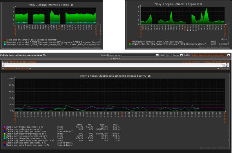

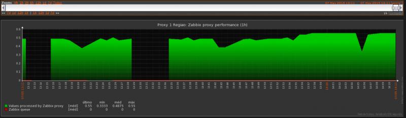

    Hello!
    I've experienced "gaps" on the web monitoring of some pages from a proxy. Not only on web monitoring, but the gaps appear on all other graphs, like "Zabbix data gathering process busy %" of that proxy. You can see the gaps and Zabbix performance graph on the atached images.
    PS.: We use Zabbix 2.2.9, on a Red Hat virtual server.
    Any help is apreciated

      I've tried to change items from "zabbix agent" to "zabbix agent (active)", but the gaps persist. I've detached all templates from the proxy, it only check 3 web scenarios now, but the gaps persist.
      I was reading something about a possibility of the network interface is being flooded... but after i detach the templates from proxy, it's queue came to 0.
      I really don't know what's happening, any other suggestions? Need more info?
      Thanks in advance

            Resolved!
            When talking with a colleague, i remembered that we are migrating from Zabbix v2.2 to v2.4 and that two zabbix-servers were using that same proxy, and that proxy could be supercharged with this situation.
            So, after delete the proxy from the new instance of Zabbix (v2.4) that we are using, the monitoring graphs become continuous again.
            I hope this help someone.
