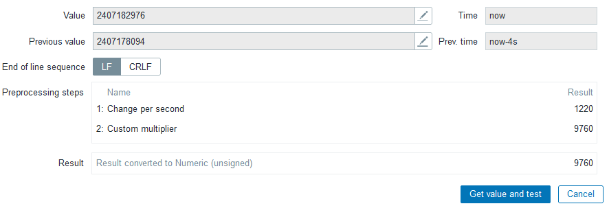

    When I test the item via Configuration -> Hosts -> Items, for each interface, I get a response, such as the one found below. I am not sure what Zabbix is doing with the data and why its not getting to the network interface graph. I am using the out of the box templates with no modification.
