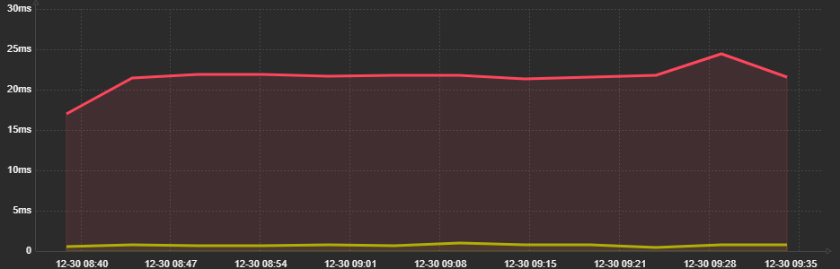

    I created a widget with "Graph" type and wanted to see an average line on it acording to the Dashboard period selector.
    As an example, the Graph bellow collects a performance mesure every 5m, but it shows not average.
    Graph with no avg line

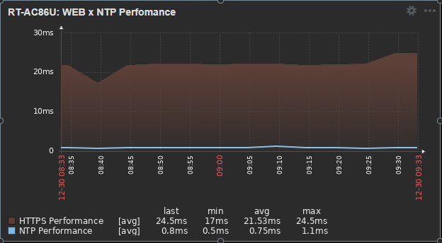

    By using a "Classic Graph" type I'm able to see the average according to the selected period but I can't draw an average line on it.
    Classic graph with no avg line
    I was hoping to draw an average line but could not find that option with "Graph" type.

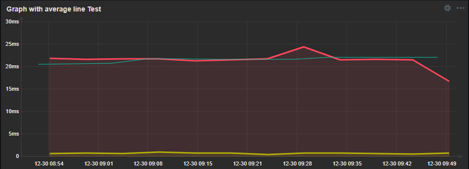

    To remediate that behavior I created another item that calculates the average of the last 5 collected values and added it to the graph as shown bellow.
        avg("net.tcp.service.perf[https,,{$HTTPS.STATUS.PORT}]",25m)
    Graph with item avg
    Is there a better way to include an average line on a Graph?

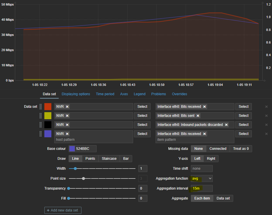

    I realized another way to draw the average line on a graph.
    We can use the aggregate function of the Graph widget pointing to the same item.
    This way there's no need for another calculated item.
    It actually works pretty good.
    graph with avg function
