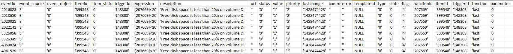

    • uKaNU
      • Mar 2015
      Thanks for your reply. I just got back from leave.
      It looks like these internal events are created by a trigger.
      (Please see my attachment)
      As I can retrieve the trigger with trigger.get, but passing the triggerid to event.get in the objectids parameter gives me nothing since all the events belonging to these triggers have the source marked as "internal event"
      Either way, something is not right here. If the events are "Internal" then why give me the trigger in the first place and if its decided to include these triggers, then why event.get does not return events belonging to these triggers?
      I have worked around it now, by going one step further and looking for the existence of events for all returned triggers.
