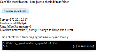

      In my zabbix_agentd.conf :
      Server=172.20.16.117
      Hostname=dt10y8p4j
      UnsafeUserParameters=1
      UserParameter=fsiz[*],cscript //nologo taillerep.vbs "$1"
      then, I check with launching agent manually and locally and i receive an answer.

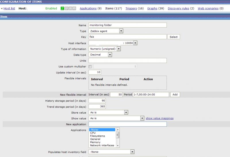

      I created an item in Zabbix
Name:	Sans titre.jpg

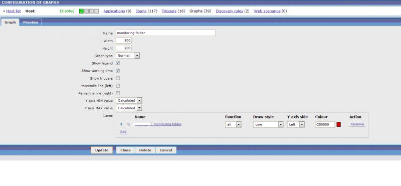

      And I created a graph in Zabbix
Name:	Sans titre1.jpg
      But, i've no data in my graph :/

      PS: Verification that agent and script run well
Name:	Sans titre3.png

          It's works ! I think that I have an error in the key field of item.
