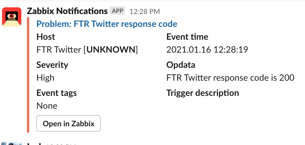

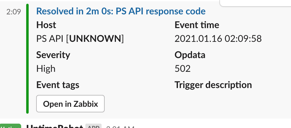

                  When I'm saying the event seem to be not resolved I mean I do not see it in the notifications. Here are two examples of resolved vs unresolved notifications in Slack
Name:	Screen Shot 2021-01-20 at 1.23.25 PM.png
ID:	417118Click image for larger version
Name:	Screen Shot 2021-01-20 at 1.23.15 PM.png
                  I do want to receive the actual response code at the time the alert is triggered.
                  I also want to receive notification when the response code is back to normal (200 in this case).
                  As a side note - what does the "(UNKNOWN)" stand for here? What field is it looking for?

                    Well now you did not mention Slack at all before. It is a very different problem than what you explained before.
                    See Slack related documentation:
                    https://www.zabbix.com/documentation...ications/media
                    You can also choose between two notification modes:
                    • alarm (default)
                      • Update messages will be attached as replies to Slack message thread
                      • Recovery message from Zabbix will update initial message
                    • event
                      • Recovery and update messages from Zabbix will be posted as new messages
                    I think you want the 2nd type....
                    Normally where it says UNKNOWN, there is the IP address of the interface/host. Again, you should check the Slack configuration. All the information you need is there and you can adjust the messages any way you want. See the "script" which is used for Slack media type.
                    title: 'Host',
                    value: '{0} [{1}]'.format(params.host_name, params.host_ip),
                    short: true
