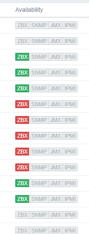

    I'd like to be able filter my Monitoring hosts list by which items have the ZBX Availability icon in green, ZBX icon in Red, or ZBX icon blank.
    I am trying to use this to determine connectivity to the zabbix agents but as more and more come online I will mainly want to see the red ones.
    I am currently only at about 350 hosts but it is still many pages to page through.
    I'd like to be able to select multiple host groups that apply to 1 or more business units and then be able to see just the Red and/or not-green ZBX Availability icons so I know which ones are having connectivity problems.
    Since I do have alot of non-server devices using ICMP only at this time I assume configuring SNMP will be the only way to get an icon lit for them since there doesn't seem to be an ICMP icon.
    It seems like this should be easy to do but I don't see how. I would hope I don't have to write script or code to do this as I am not a programmer, just an experienced hardware/OS/Virtualization/Networking guy.

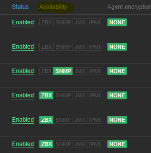

    Do you mean filter or order hosts by availability column?

      Yes that's exactly what I figured would already exist but doesn't seem to. Give anybody columns of anything and they will want to be able to sort each colmn for some reason right
      I am on the Monitoring --> Hosts page and have selected some of my host groups and would now like to see just teh onses with ZBX in red or possibly SNMP in red since ICMP isn't an option.

        It seems to me that this Availability column is not as simple as the other columns, as it is made of dynamic objects, not strings.
        For now I don't think it is available.
