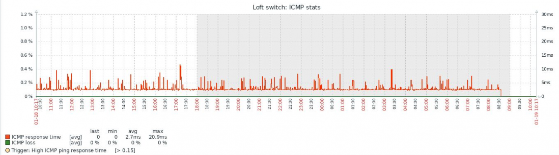

    IPv6 hosts added by name don't seem to experience packet loss
    Power supply on switch blew a few hours ago. The only alert I have in Zabbix, however, is that SNMP stopped responding. If I look at ICMP, you can see where it went off because ping time goes to 0, but packet loss is staying at 0% when I would expect it to be 100%:

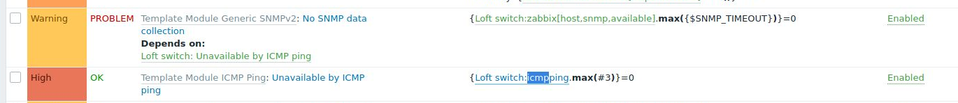

    The "Unavailable by ICMP ping" trigger is staying on OK:
    The device in question has an AAAA record and no A record.
    Zabbix version is 5.0.7.
