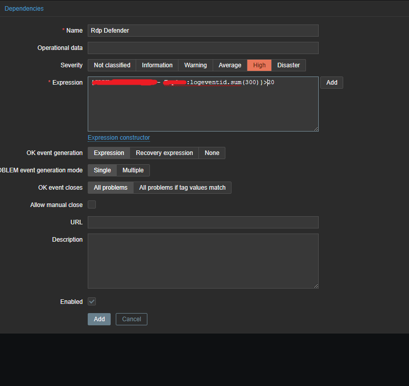

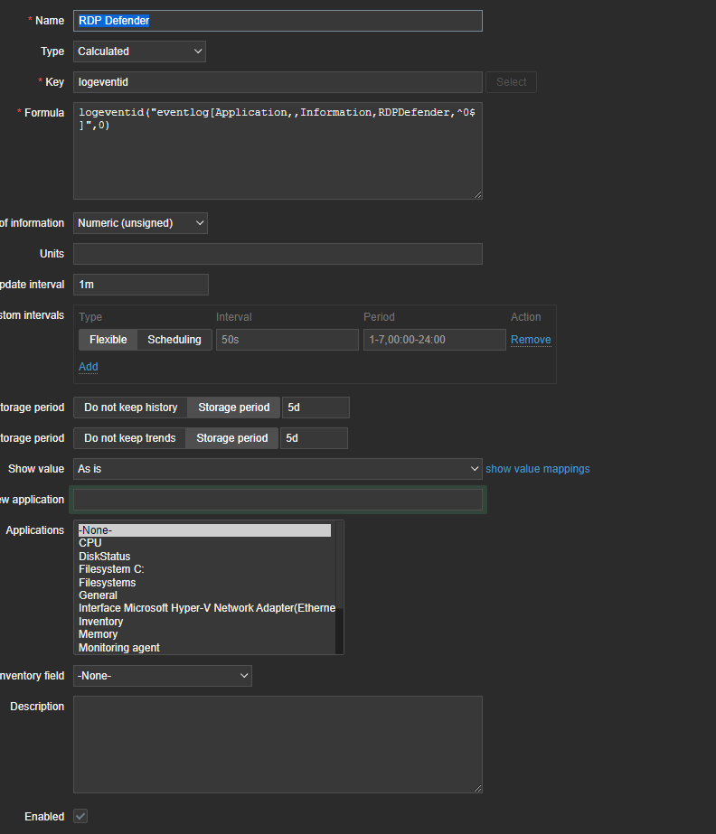

      hi! I'm really sorry to bother You, i created the item and put the term eventlog in key field. I created a trigger but it does not work, it turns gray (the trigger shows the just key field, not the formula). I need to create a trigger that alerts me when there are more than 20 specific events in a lapse of time. But i'm doing something wrong. Many thanks, Sara
      • Hamardaban
        • May 2019
        • 2714
        Show a screenshot of the item and the trigger.
        • Sara.Art
          • Jun 2020
          • 52
          Hi Hamardaban, thank you very much again. I attached the screenshot You requested, I think the problem is about the trigger syntax, it does not contain all the informations... (Cannot evaluate function "logeventid(0)" So I have to compile the key field with right data. Plus, is there a way to tell the trigger not to include certain data? (I mean the events containing e.g. 127.0.0.1) Thank You and have a nice day! Sara
