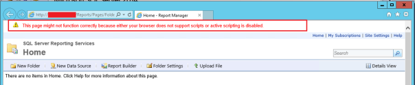

    Hey,
    I'm trying to get a URL widget to work on a MS SQL report server page.
    But all I get is:
    (this image is not from my set-up, I use firefox as a browser. The error message is the same)
    When I open the page with the same URL in another tab, it opens correctly.
    Does the zabbix URL widget use some kind of other browsing method other then the browser itself, can I change something so that the widget can use active scripting?
    I read that this can be fixed by adding the website to trusted website, but that is for a browser and not a widget in the browser.

    The solution was found in the following topic
    Administration > General > Other (from the dropdown menu) > Untick Use iframe sandboxing
