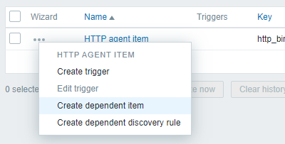

    I create the "HTTP agent item". I use the wizard to create a dependent item.

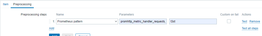

    After choosing the "preprocessing" sub-tab, I pick "Prometheus pattern" and add a parameter.
    Click image for larger version  Name:	prometheus_problem_02.png Views:	10 Size:	11.1 KB ID:	418027
    The documentation seems to suggest that I can put in a pattern that would exist from Prometheus' /metrics page. I picked promhttp_metric_handler_requests_total{code=".*"} because there's 3 of them:

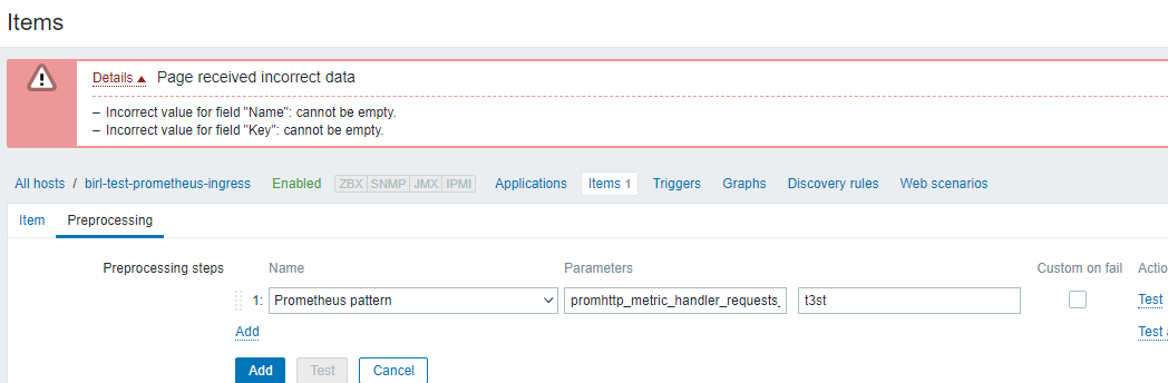

    However, trying to add it fails:
    Click image for larger version  Name:	prometheus_problem_03.png Views:	11 Size:	27.6 KB ID:	418028
    That error message is rather confusing: Where's "name" and "key"
    are they 2nd and 3rd fields I filled in here?
    Or is promhttp_metric_handler_requests_total the key and the name {code=".*"}?
    Or is code the key and ".*" the name?
    And then, what defines "empty"?

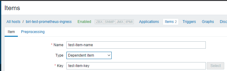

    The answer:
    I was not aware that the required fields under the "Item" sub-tab still needed to be filled in. I, incorrectly, assumed that "Preprocessing" sub-tab took care (or negated) the "Item" fields.
