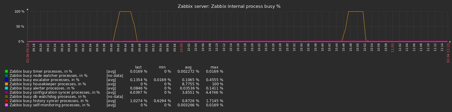

    Right after "Zabbix busy housekeeper processes" is going up to 100%, zabbix is reporting the agents offline for about 30 minutes.
    In the zabbix-server.log I can find these entries:
    1638:20210204:075313.842 slow query: 1276.477113 sec, "insert into history_uint (itemid,clock,ns,value) values
    1640:20210204:075313.845 slow query: 1276.482763 sec, "insert into history_uint (itemid,clock,ns,value) values
    1636:20210204:080310.057 slow query: 1871.690660 sec, "insert into history_uint (itemid,clock,ns,value) values
    1638:20210204:080310.060 slow query: 596.042016 sec, "insert into history_uint (itemid,clock,ns,value) values
    1641:20210204:080310.066 slow query: 596.201410 sec, "insert into history_uint (itemid,clock,ns,value) values
    1640:20210204:080310.068 slow query: 596.168927 sec, "insert into history_uint (itemid,clock,ns,value) values

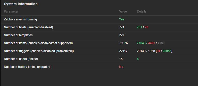

    Here are some screenshots:
    Please let me know, if you need more information.
