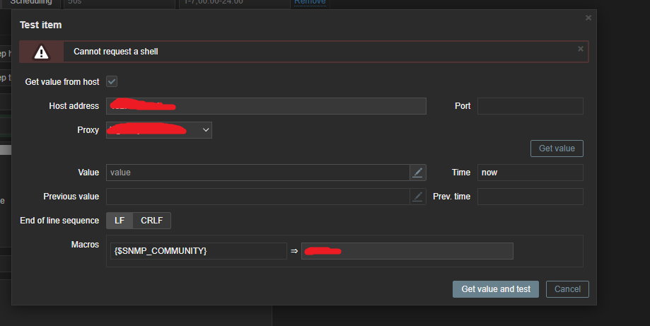

    Cannot request a shell

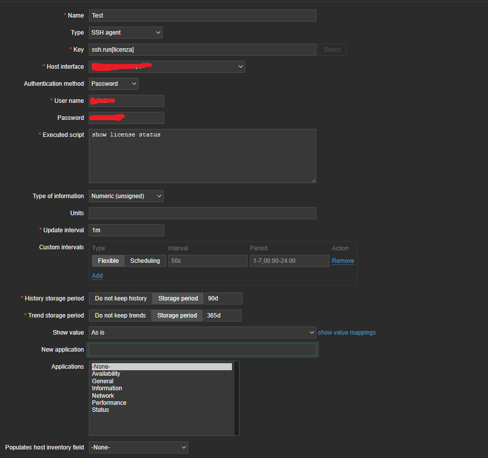

    Hi! Still having troubles, sorry. In this case I'm trying to create an item with ssh agent. Is the authetication key mandatory? When I'm going to test it and push the button get value, the error displayed is "cannot request a shell"). I see the ip in the field "host address" but the field port number is blank and i cannot fill it.
    I wonder if I have to use the authetication key in order to use ssh agent (I'd like to collect some information via ssh) and so I receive the error cannot request a shell.
    I've searched about this error but I found very little information. Could You help me? I thank You very nmuch in advance. Have a nice day, Sara

    I also have this issue and am trying to use password authentication, not SSH keys.
    Unlike other items, once it goes in to Not Supported, you cannot get it to try again until it is removed and re-added. Strange.

      Hi Troffasky, I haven't resolved yet this issue. I've a sort of workaround but it has some limits. I created an item "external check" and then I created an sh.script in usr/lib/zabbix/externalchecks, which becomes the key (i set the timeout to 15 in zabbix-server.conf and StrictHostKeyChecking no in config_ssh, then reboot both the services). I also added some preprocessing steps. But I can use this item just for one host (because the ip address should be pointed inside the file, so I must create several files and items, sigh). Have a nice day, Sara

          my problem is: cannot close generic session channel: Failed waiting for channel success
