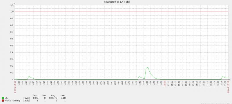

                I understand that, but i am talking about Graph, that shows that my server always have 1 running process, which is not true:

                  guys, I want that you pay attention to this, because your competitor ganglia doesn't have such issue. In Running processes graph it doesn't calculate gmond process(ganglia agent)
