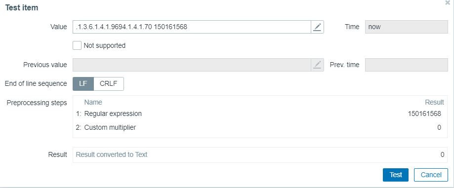

    I have an item where I receive a trap where it contains a number in bps
    .1.3.6.1.4.1.9694.1.4.1.70 371107776
    So what I want is to change it to Gbps
    At preprocessing steps how do I configure it in order to get the output of the regular expression and then change it to Gbps?

    Maybe I was not clear enough, I know how to convert......I am asking how to configure it in Zabbix
    Cause the way I have it now is not working
    I want the steps. maybe there is an example?

      how do I change result to Numeric ?

          but at the end I want to combine values from the trap in order to present them to the users as a description, if I change it to float this might not work

              Custom multiplier... as you have it there...
                "Type of information" in item config. If you receive 0 here, you probably have it as "numeric(unsigned)". Change to "float".
                  Remeber, that this "type" affects, how value is saved, not how it is retrieved.... so you can query for text, but after preprocessing you have a floating point number... that is how you need to save it.
                    Well, I have never dealt with traps in Zabbix. Just followed the initial post, which only displayed one value. Never thought of different things coming in that way.. Not really sure how this combining into one works... But if changing type is not possible, then I would question also doing any of preprocessing. If you regex already for one specific OID, then receiving any other value will render that item "not supported" as preprocessing fails...
