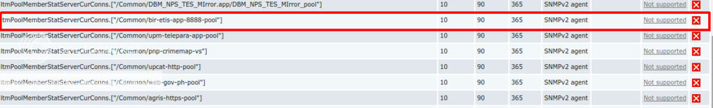

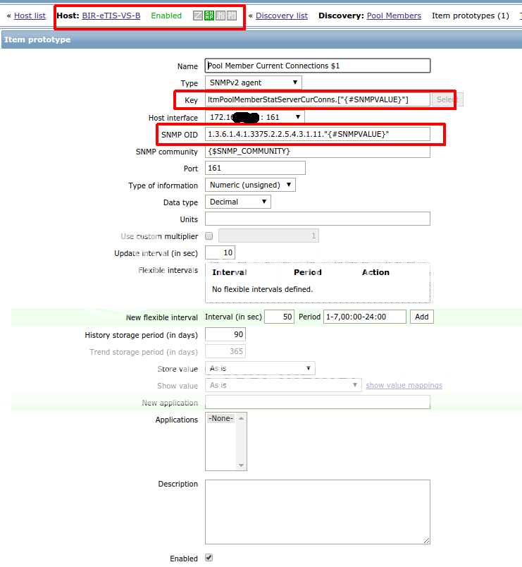

    Hi Zabbix Masters,
    Once again i need your help, I've been trying to Graph the current connection of Virtual Servers inside a Pool. I can successfully get the values by CLI snmpwalk using ltmPoolMemberStatServerCurConns or 1.3.6.1.4.1.3375.2.2.5.4.3.1.11 OID. But whenever i try to configure this to my Zabbix discovery rules i always get an error status "not supported". Im already running out of ideas huhu. I have attached some screenshot for your reference.

    Your setting on Zabbix:
    Key:
    ltmPoolMemberStatServerCurConns.["/Common/bir-etis-app-8888-pool"]
    SNMP OID:
    .1.3.6.1.4.1.3375.2.2.5.4.3.1.11."/Common/bir-etis-app-8888-pool"
    Trancerate to string from SNMP OID
    F5-BIGIP-LOCAL-MIB::ltmPoolMemberStatServerCurConns."/Common/bir-etis-app-8888-pool"
    OID by snmpwalk:
    F5-BIGIP-LOCAL-MIB::ltmPoolMemberStatServerCurConns."/Common/bir-etis-app-8888-pool"."/Common/bir-etis-app1".8888
    That is not matched OID between Zabbix setting with snmpwalk result.
    I think that it is necessary to consider how to set.
