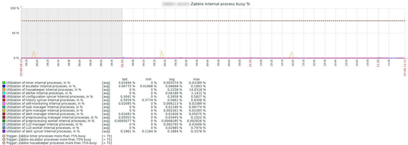

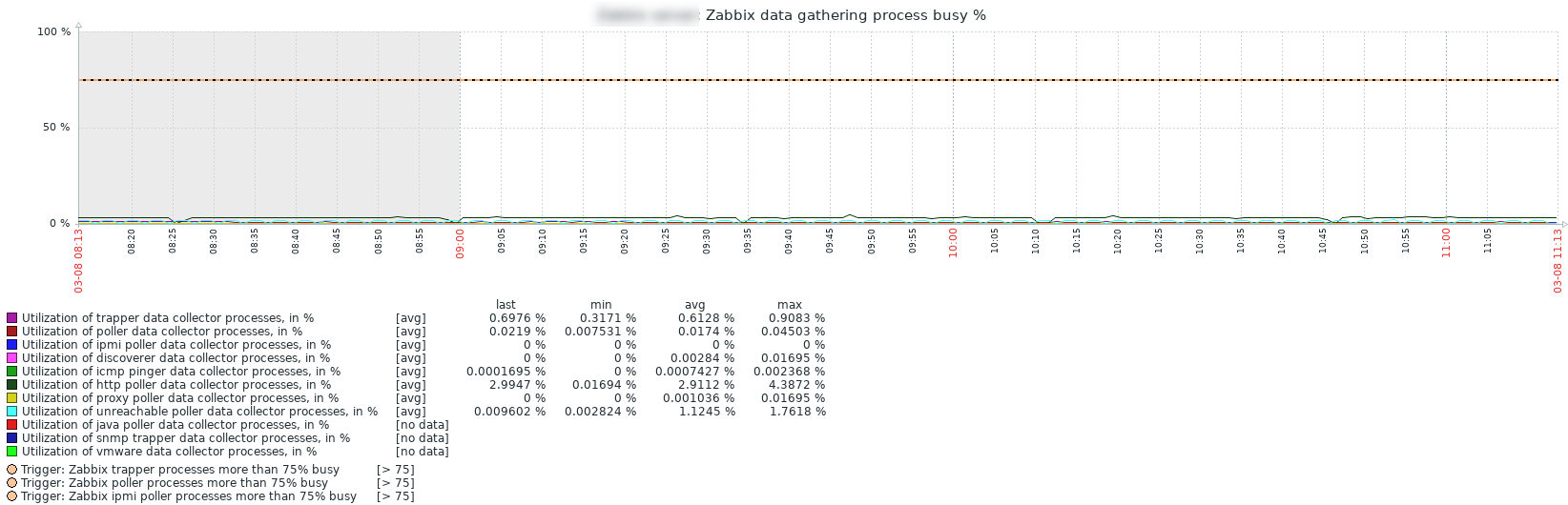

    From the server graphs I can see the following information about the server status:
    Click image for larger version  Name:	data gathering process busy.png Views:	0 Size:	80.3 KB ID:	420206
    Click image for larger version  Name:	internal process busy.png Views:	0 Size:	100.4 KB ID:	420207
    It looks ok, but the server performance is horrible :

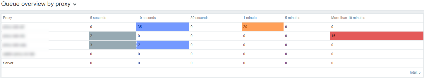

      • Himura
        • Feb 2021
        • 14
        UPD: unlink and clear all the data for the test. Now I can see the following situation
Name:	queue overview.png
        Could someone help, please ?

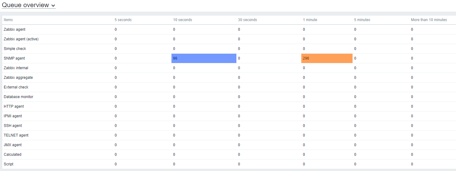

          • Himura
            • Feb 2021
            • 14
            Hello Hamardaban and thank you for your support!
            I've turned off the bulk request as you've adviced. Situation is the following.
            From the proxy logs I can see a lot of similar logs
            41551:20210314:204256.684 SNMP agent item "ap-clients-[]" on host "Wireless Controller" failed: first network error, wait for 15 seconds
            41559:20210314:204311.697 resuming SNMP agent checks on host "Wireless Controller": connection restored
            41524:20210314:204356.716 SNMP agent item "ap-eth-download[]" on host "Wireless Controller" failed: first network error, wait for 15 seconds
            41563:20210314:204411.282 resuming SNMP agent checks on host "Wireless Controller": connection restored
            41534:20210314:204456.781 SNMP agent item "ap-eth-download[]" on host "Wireless Controller" failed: first network error, wait for 15 seconds
            41559:20210314:204511.648 resuming SNMP agent checks on host "Wireless Controller": connection restored
            41552:20210314:204556.432 SNMP agent item "net.if.speed[ifHighSpeed.14]" on host "Wireless Controller" failed: first network error, wait for 15 seconds
            41559:20210314:204611.986 resuming SNMP agent checks on host "Wireless Controller": connection restored
            41538:20210314:204656.496 SNMP agent item "ap-radio-state-2ghz-[]" on host "Wireless Controller" failed: first network error, wait for 15 seconds
            41562:20210314:204712.009 resuming SNMP agent checks on host "Wireless Controller": connection restored
            But when any new entry appears I'm able to do snmpwalk for the conrete parameter and receive the needed data.
            Any advices or help will be really appreciated.
