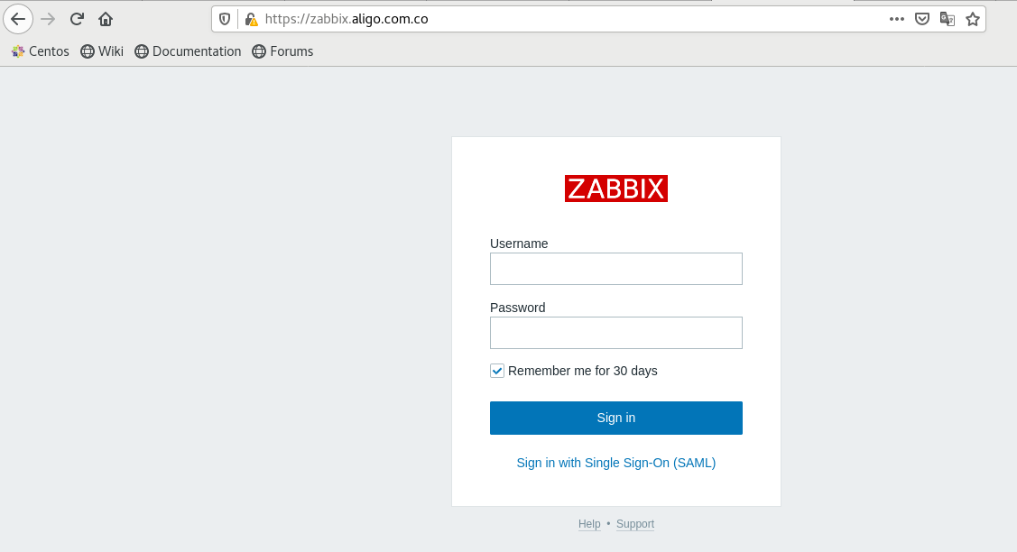

    first, I exposed the zabbix server on port 443 with their respective SSL certificates. This server run with CENTOS8
Name:	Captura de pantalla de 2021-03-08 19-08-16.png

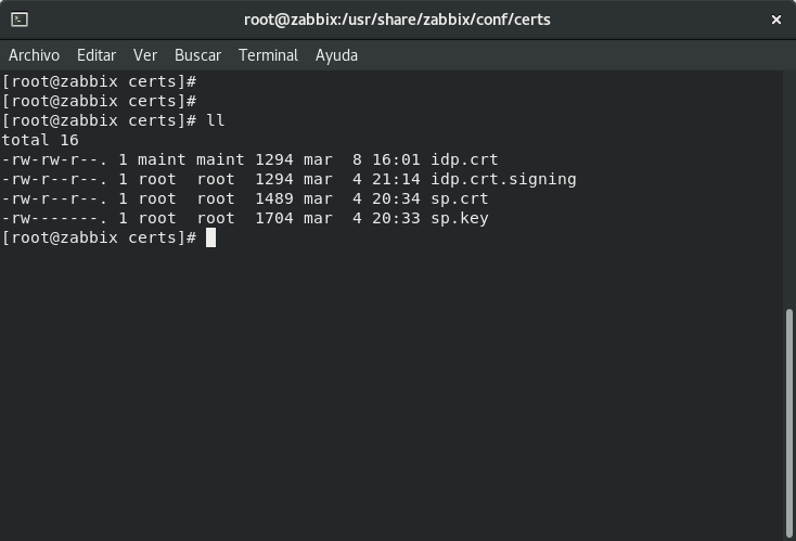

    Then put the certificates in the recommended folder, including the idp.crt
Name:	Captura de pantalla de 2021-03-08 19-18-50.png

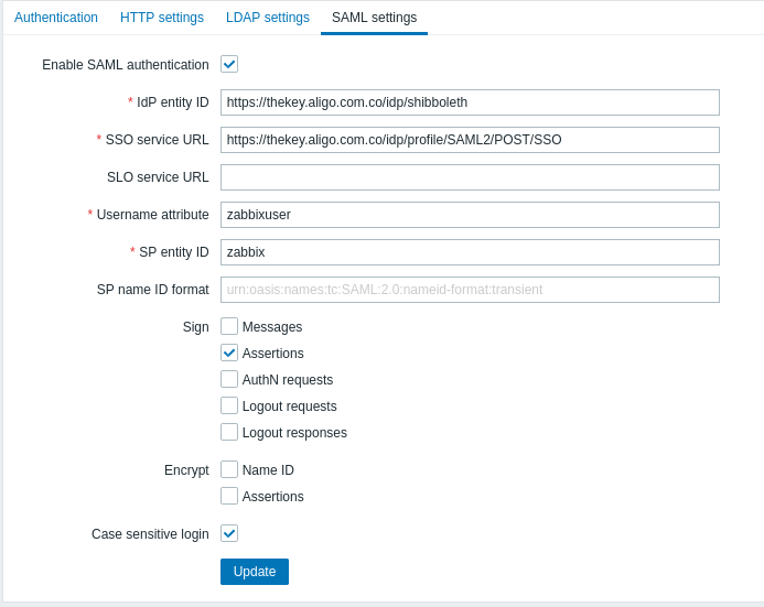

    This is the SAML configuration that I have in zabbix
Name:	Captura de pantalla de 2021-03-08 19-22-12.png

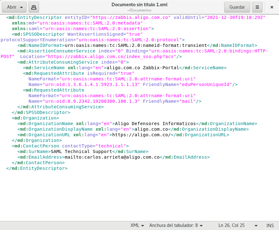

    and this is the metadata that you create to create the trust relationship with the IDP:
Name:	Captura de pantalla de 2021-03-08 19-30-35.png

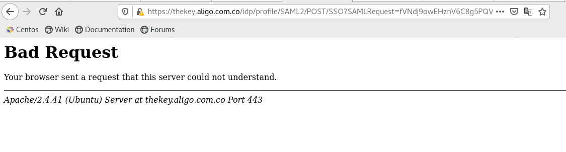

    When I try to authenticate, I receive this message from apache
Name:	Captura de pantalla de 2021-03-08 19-32-25.png

    1) the certificate that is saved in the path ui / conf / certs / idp.crt is the signing or the encryption?

    3) is there an error in the SAML parameterization in zabbix?
