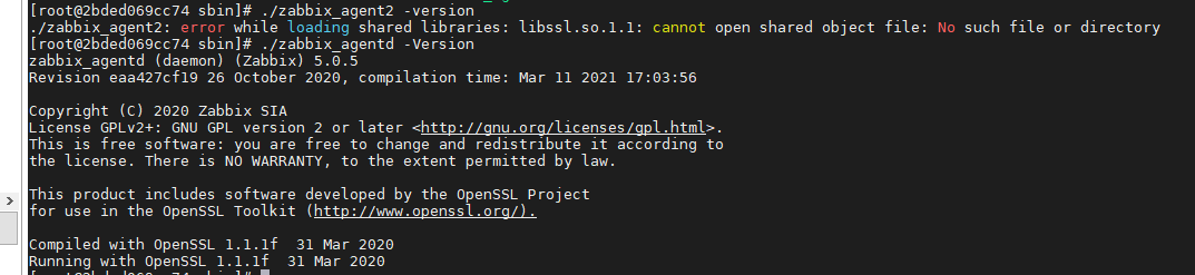

    I am trying to build zabbix agent2 with statically linked libraries, which I can distribute among different servers. However, when I started agent2 in a different server without related libraries, it still asked for required libraries, while the zabbix_agentd compiled together work well.

    The error information when start agent2 is as following:
    ./zabbix_agent2: error while loading shared libraries: libssl.so.1.1: cannot open shared object file: No such file or directory

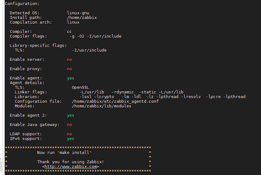

    The configure code is:
    ./configure --prefix=/home/zabbix --enable-agent --with-openssl --with-libpcre --enable-ipv6 --enable-agent2 --enable-static
    The configure result is:

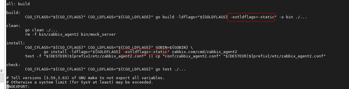

    Finally I managed it.
    This is how I get it work.
    First, configure it with command: ./configure --prefix=/home/zabbix --enable-agent --with-openssl --with-libpcre --enable-ipv6 --enable-agent2 --enable-static
    Then, edit the Makefile generated for agent2 src/go/Makefile, add -extldflags=-static to -ldflags for go build and go install as following:
    Click image for larger version  Name:	screen.PNG Views:	0 Size:	25.1 KB ID:	420543
    Now make and make install and we will get the agent2 compiled with statically lined libraries.
