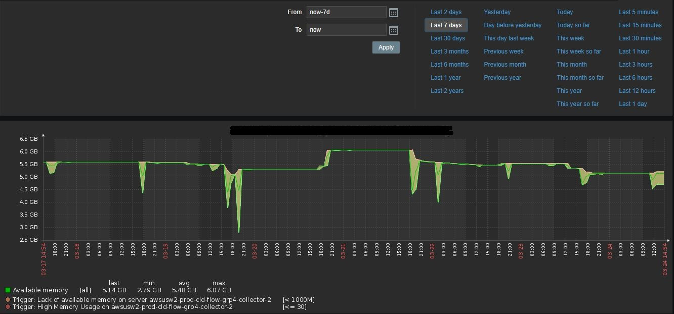

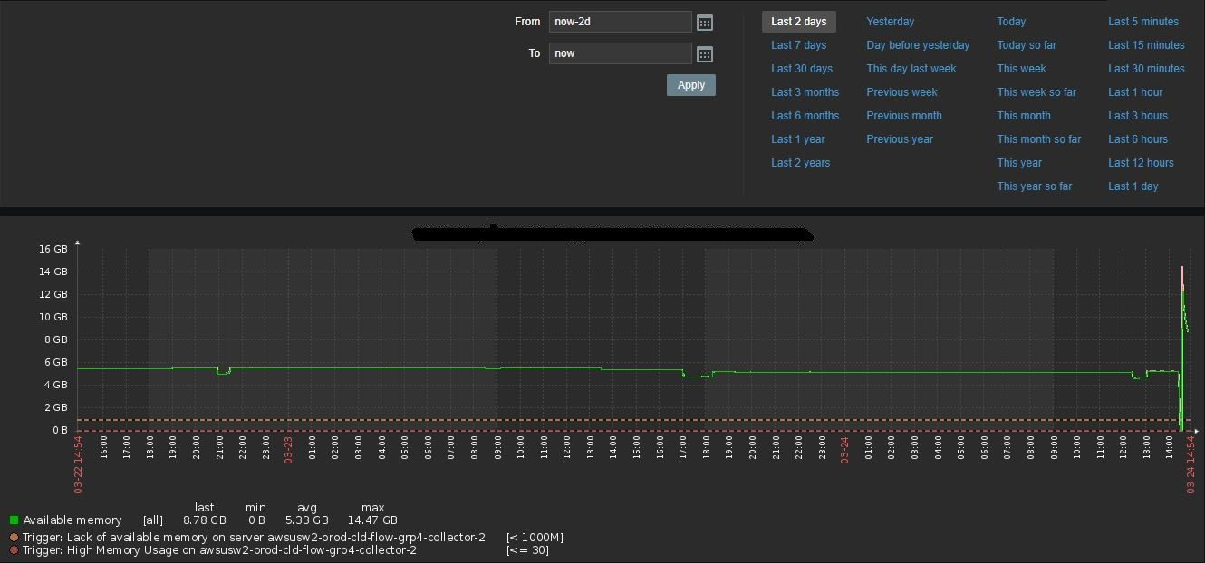

    When checking latest data :
    If I select duration as 2 days, then, I can see the graph reaching to value 0 which is entirely correct.
    However if I select duration as 7 days, the graph does not shows itself dipping to 0 value.
    Am I missing something with the behavior of the graph ?
    Click image for larger version  Name:	pic_2_days.JPG Views:	2 Size:	138.3 KB ID:	421436
    Click image for larger version  Name:	image_18678.jpg Views:	8 Size:	135.9 KB ID:	421435

      Data is taken from different sources: 2d-from history, 7d - from trends. Read the documentation and use the forum search.
