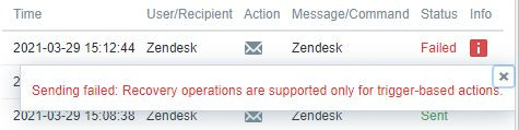

    Would you please explain it to me. I have the Zabbix server and Zendesk tickets system. I have configured Zendesk Media. I see, tickets was created on the Zendesk but not closed if trigger was change severity from Problem to OK. I don't have any ideas what need put in Recovery operations, or Zabbix + Zendesk works one way create a new tickets only or need make a script. If I try to set up Zendesk user to recovery,
    Zendesk config
    I receive messages:
    Error
    If anyone has experience configure the Zabbix and Zendesk + closing or change of status (tickets), I will be grateful if you share...

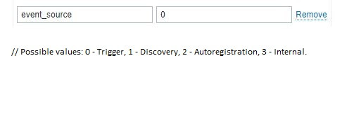

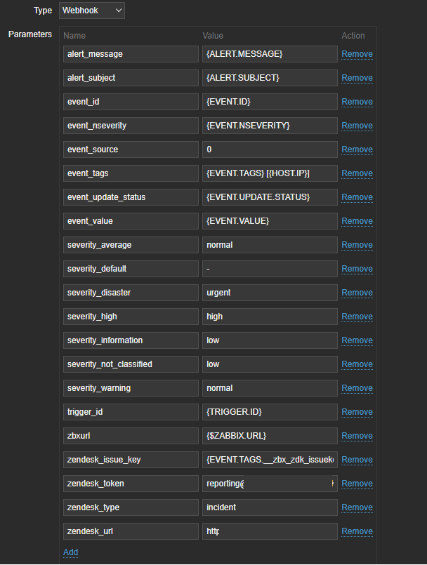

    I found the problem in the script:
    Status
    In my case 0 - Trigger and vuala
    Example
    Maybe someone will need it.

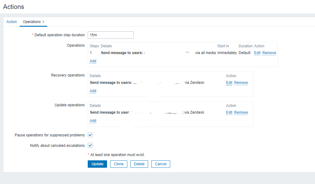

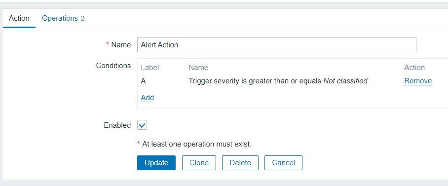

        Can you check in your Configuration -> Actions tab -> Trigger actions. You need some like this (open and recovery Actions add Zendesk):
        Click image for larger version  Name:	image.png Views:	0 Size:	26.9 KB ID:	453035

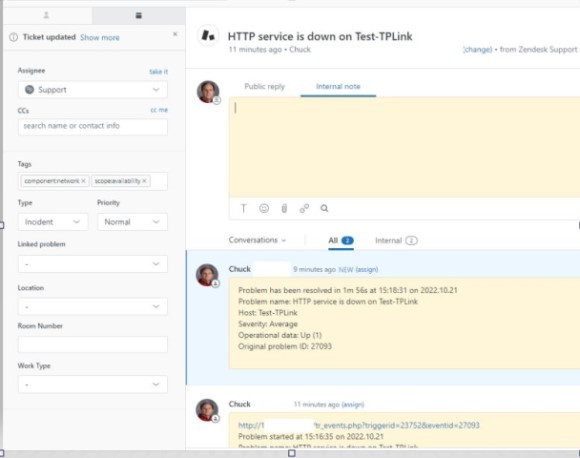

ID:	453042 I do have the settings. It will update the ticket but not close. Do I need to create a Parameters field or edit the script?
          Last ticket update says
          Problem has been resolved in 1m 56s at 11:17:31 on 2022.10.21
          Problem name: HTTP service is down on Test-
          Host: Test-
          Severity: Average
          Operational data: Up (1)
          Original problem ID: 27079​
          Click image for larger version  Name:	Zendesk1.png Views:	0 Size:	35.8 KB ID:	453041

                Hm, can you please for test remove in Actions - "Update operations" and check what happens
                • cthompson@baylor
                  • Oct 2022
                  I removed "Update operations". Under operations. And I still have the same results. Here is Action tab if that helps.

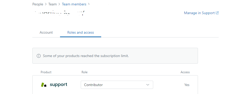

                    Ok, thanks, looks like from the Zabbix side all is good. Can you check, your user in Zendesk has access to close the ticket? I don't have now access to the Zendesk admin panel and check. I try today recheck my Zabbix zendesk script, maybe I some miss.
                    • He-ba
                      • Mar 2021
                      • 15
                      Ok, can you please check in Zendesk -> Admin Dashboard -> username this:

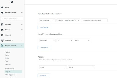

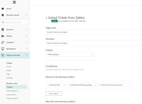

                        You have been a great help on this. I checked in Zendesk and I'm using an admin account vs Contributor for now. What I was able to do to get it to close the ticket was create a rule in Zendesk.
                        . Click image for larger version  Name:	Zr2.jpg Views:	0 Size:	20.8 KB ID:	453362

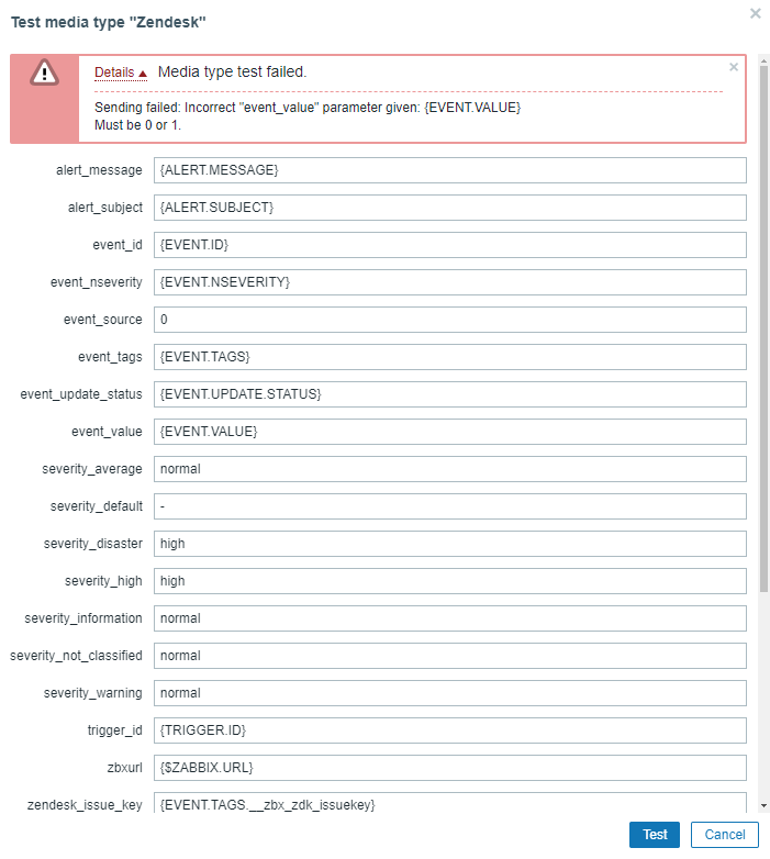

                            Hey!
                            Saw your thread about Zendesk
                            Im sitting with a problem when it come to updating the tickets.
                            But when I try the settings you show in here, it does not work. I get warnings and only way to make it work and send events is to use "1" as event_value and "0" as event_update_status which deactivate the update possibility.
                            So right now I only get new tickets, both new events and updates or recoverys.
                            Is thera anything that needs to be changed in the script or do I need more settings and Macros than they say in the instruction?

                              #15
                              Sorry I didn't see your message. From the Zendesk side, do your user privileges have to open and close the ticket? It's my last work config from zabbix side, sorry right now i cannot show you from Zendesk side.
