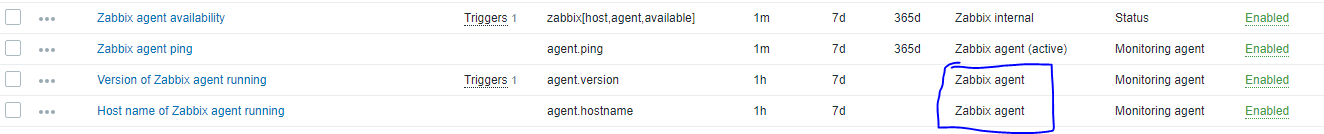

        As you are using Zabbix Agent Active template only, then host will not show in Green. You can give a try by adding additional template like "Template Module Zabbix Agent" not the "Template Module Zabbix Agent Active", then you will see the host shows in green.
        You can verify the Items of your windows host has any Zabbix agent (Passive Check) marked in blue.
