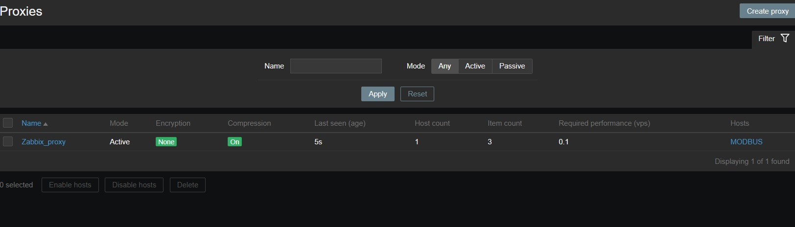

    I have the following scenario:
    Zabbix Server on a ubuntu vm, Zabbix Proxy on a Raspberry PI, and a sensor device connected to the Raspberry PI via USB (USB convert RS485).
    I tested a python script on the Raspberry PI and I can collect the data correctly from the equipment via modbus, that is, the communication via modbus between the raspberry pi and the equipment is working.
    My goal: I want the Zabbix Proxy configured on the Raspberry to do this collection via modbus.

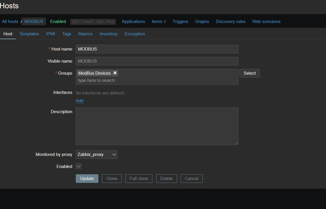

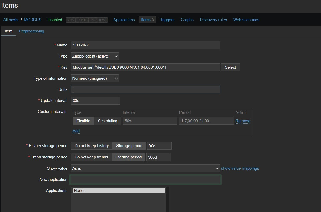

    I tried to create a host (monitored by Proxy) and configure the following item:
    Zabbix Agent (Active)
    keys:
    Modbus.get [“/ dev / ttyUSB0 9600 N", 01.04.0001.0001] or
    Modbus.get [“/ dev / ttyUSB0: 9600: 8N", 01.04.0001.0001]
    But it did not work. I don't know if the problem is in the item, host or proxy. I didn't find much information about Modbus.get on the internet.

    I got this error "Unknown metric Modbus.get" on item
    • Hamardaban
      • May 2019
      • 2714
      According to the documentation, you are incorrectly specifying the connection parameters, in particular the endpoint
      First, specify the protocol - rtu or ascii

        I tried diferents ways like:
        Modbus.get["rtu://ttyUSB0",01,04,0001,0001]
        Modbus.get["rtu://ttyS0:9600",01,04,0001,0001]
        Modbus.get[rtu://ttyUSB0:9600:8n,01,04,0001,0001]
        Modbus.get[ascii://ttyUSB0,01,04,0001,0001]
        Modbus.get["rtu://dev/ttyUSB0:9600",01,04,0001,0001]
        Modbus.get[rtu://dev/ttyUSB0,01,04,0001,0001]
        Modbus.get["/dev/ttyUSB0 9600 N",01,04,0001,0001]
        Modbus.get["/dev/ttyUSB0:9600:8n",01,04,0001,0001]
        But it still didnt work.

                  update, i tried again the modbus.get e now a got this:
                  2021/04/05 13:00:37.000729 check 'modbus.get["rtu://dev/ttyUSB0:9600:8n1",1,4,30001,1,int8,le,4]' is not supported: Unable to connect: permission denied
                  So it looks like I have to give zabbix some specific permission
                  • dade
                    • Jan 2021
                    • 34
                    UPDATE: SOLVED
                    I did: sudo usermod -a -G dialout zabbix
                    So modbus.get worked!!! Thanks Hamardaban
